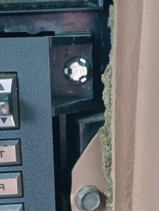

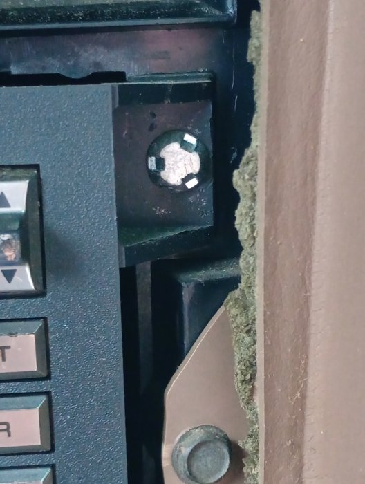

I've got the parts order so now just waiting. Trying to get this radio out. I don't know if they all had this bolt but it's aggravating

It seems to be hit and miss for that security bolt. I've only run across it a couple times but there's a cheap socket you can get for it with the other regular radio removal tools like the Ford wire loops.

Ugh, PITA. My '89 AHB had one and I ordered the bit online. I tried without one but it was a no go for me. It was just too darn tight.

I got them out today. Orielys didn't have one so I went to the local car audio shop and he let me borrow it. Said it's the first time he had to use it

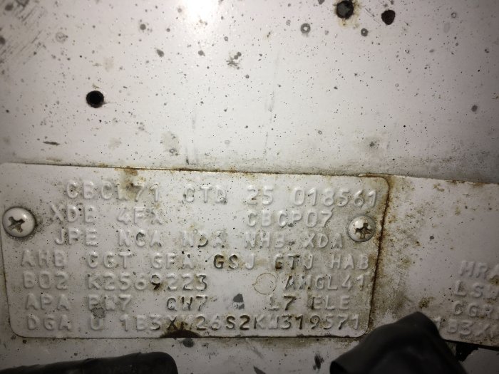

Hey LSM....What does the AHB stand for?
Chrysler's code for Police Package. Shows on fender tag. Middle left "AHB" and second from bottom row, to right "ELE" meaning HD 4bbl. This is my '89. Also eighth character in VIN "S" meaning HD 4 barrel. a "P" would be civi 2 bbl and a "4" would be HD 2 bbl

Hard to imagine there was a time in which anyone would want to steal the stock stereos in these lol.. I'm sure you will, but don't put that security bolt back in, just use a hex head.
