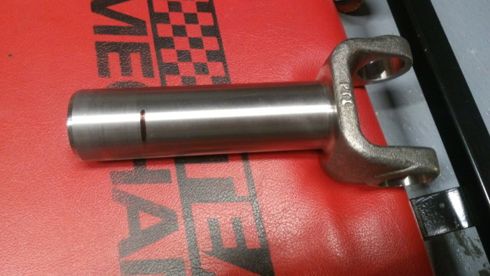

Bud, yokey has arrived in nz :) still a few days away from getting to me
No.
There are no (loose) 904 tailhousing bushings in my inventory.
There are two 904 transmissions in my garage - but still together.
There are a couple of transmission specification books in my bookshelf – and they have measurements/specifications on just about everything – except for this.
Without purchasing a new bushing and measuring it – I’m afraid I’m of no help on this matter.
I do think that something is out-of-round – which would be either the tailhousing (at the bushing) and/or the slip yoke.
The slip yoke is difficult to make out-of-round (and difficult to fix, if it is).
The tailhousing can be quite easy to make out-of-round (dropping the tail end on the ground, etc.), and would be rather difficult to diagnosis or fix in car.
With the tail housing removed, it would be easy to measure (with inside micrometer or with calipers). It could also be fixed fairly easily with a press or large vice. Just lightly squeeze it in small increments, release and re-measure (or insert slip yoke). Repeat as necessary, then reinstall the tail housing assy. The speedometer gear will not need to be removed for this.

there seems to be no specs supplied anywhere, but for 727 there is. Weird, my yokey didn't arrive today, maybe he will be here tomorrow. Thanks for looking Bud.

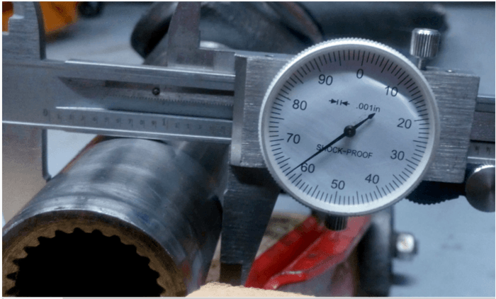

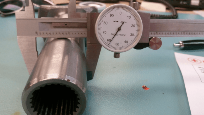

Right it just turned up and I have my vernier at work, she is smaller!
This is the lockup yoke, anyone got any ideas why they changed size or if it will make a difference.

Lock-up transmissions provide more vibration and noise, maybe that has something to do with it. Was it something that coincided with the tall gear ratio transmission that came out in ....was it 1981?

if you give the bearing 3thou oil tolerance and the yoke is 1.5625" that's 1.5665" bearing ID and then if you put a 1.558" yoke into that your going to have 7.5 thou slop in the tail housing bearing? Me's a finking that is a little to much, rattle rattle rattle
Have you tried to slide it in, yet (before transferring yokes)?

The trans guy here said that his books list 2 different part numbers, one before 78 and one after 78 but there was no description of what the difference was. So I now have a pre 70 trans and a pre 78 yoke size, hoping they make love!
Don’t take the entire transmission out. Just remove the tailhousing.
If you jack up the rear of vehicle (and not level), then you will experience very little (if any) fluid loss. If car is to be jacked up level, then you will need to drain out about 2 quarts (2 L) of fluid, first. If your catch can is clean – then you should be able to reuse the fluid (if drained).

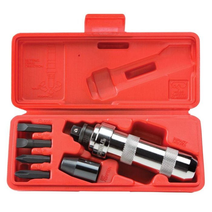

For Extension housing removal/replacement, the only special tool is snap ring pliers and possibly an impact screwdriver to loosen the Philips head screws that hold the plate to the snap ring. Regular snap ring pliers can be used. Use a large pair and make sure it expands when handles are squeezed. In most cases, the impact screwdriver is not needed – except in units that hasn’t been serviced in a long time. Your experience may differ.
An impact screwdriver looks like (if needed):
Below are procedures to remove the extension housing in car.
This is from my ’77 FSM – so some minor differences – but basically will be the same.
The speedometer adaptor will need to come out (you can leave it attached to the cable, if wanted).
Once out, I have a feeling the bushing area will be out of round. If so, take the housing to a vice or press and gently apply pressure the other direction and it will straighten out (at bushing area). Apply too much pressure and think of what happens when you squeeze an empty aluminum can.
After you release pressure, you can use your new yoke to test fit.

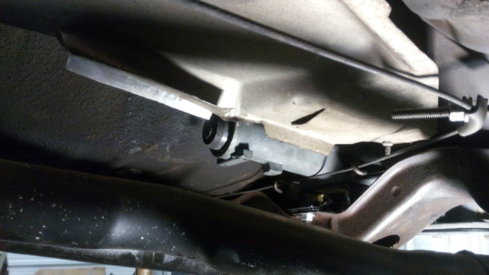

Dropped exhaust, cross member, took trans mount off, got bearing snap ring cover off and ran out of time so a little bit of progress, that snap ring looks a right prick of a thing! The fun begins...
