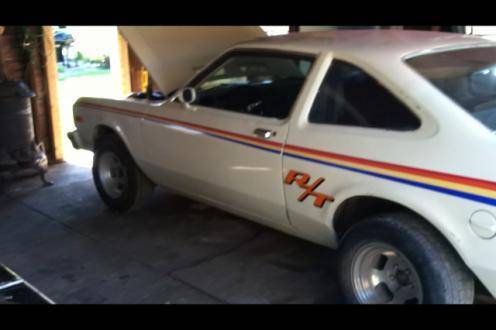

In a few weeks, I will be taking the first 1/4 mile run in my Volare' in its current set up. My coworker has looked at my car and has put his 2 cents at 14:28 based on his set ups. I'm still not dialed in with the tune- carb and timing. Plus, I need to get more seat time to get past driver error. I've made some dumb moves at the wheel with sleepy reaction time and pissy launches. I'll post slips
Whats the combo? My old aspen with 340, 3500 stall 904, 486 gears and 28 inch tire ran 13.37 at a whopping 98mph! It ran out of gear about 1000ft mark. It is fun no matter what and very addicting.
