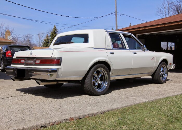

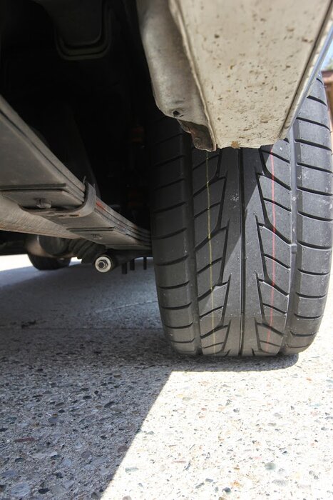

I'm running 18x9 rims on the back of my car with 285-40-18 tires. I can't remember the offset though. Probably doesn't matter because my axle isn't factory dimensions. The rim and tire do fit though without one iota of space on either side. I will rub ever so slightly on the in the top of wheel well if it gets traction.
Keep in mind also, the rear seat belt retractor mounting protrusion when choosing tire size. That's usually where a tire will interfere with the wheelwell first.

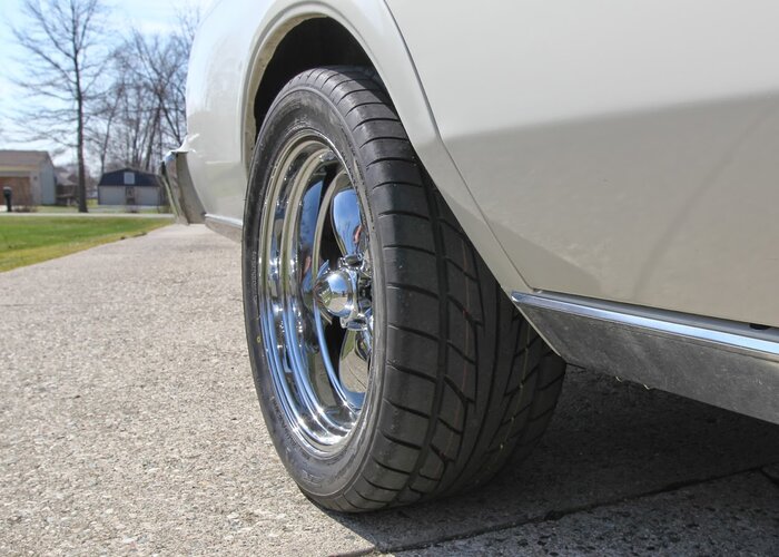

George, that stance is absolutely intimidating. Totally badass. I only wish I could go back and put the money into an RMS front end rather than the thousands I dumped in the factory setup.
You can get the 10” rim in the stock wheel well, getting it in with a tire takes a little finesse…
