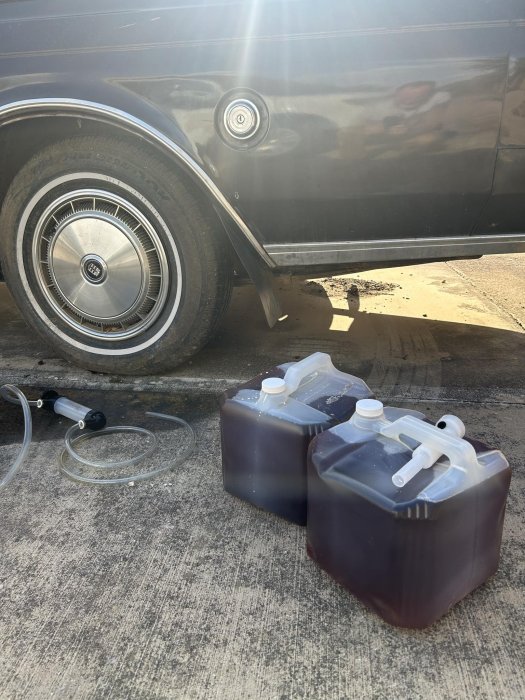

It looks like my fuel tank has more than just old gas in the tank. I noticed rust flakes as I got down to the bottom of the barrel. Has anyone removed their fuel tank, and if so, can anyone make suggestions or list some dos and don'ts that they learned from their experience?

I'm curious about that too. I keep getting alternating readings of a quarter of a tank, an eighth of a tank and completely empty. I feel like it should be very close to empty by this time. When I put the vacuum pumper tube into the tank, it felt like it went past a little trap door or something, and there was a sweet spot in being able to retrieve the fuel out of it. I managed to remove about six gallons out of the tank, and it was reading at it's highest point a quarter of a tank. That makes sense for a 20-gallon tank. When I banged on the bottom, it seemed empty. But then it tried to read about 40 miles to empty or the first hash mark after E. So, who knows. It's definitely giving me some interesting readings up in the cockpit. Do you know if these fuel tank sending units are still around? I know the one for my Imperial is damn-near impossible to find.
