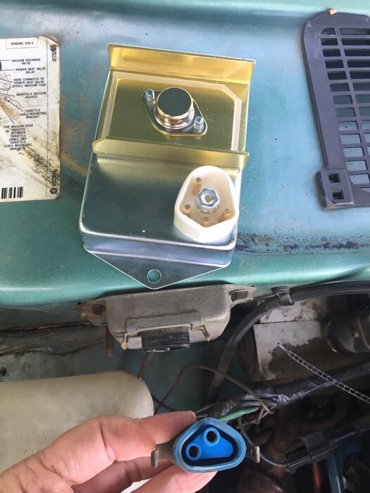

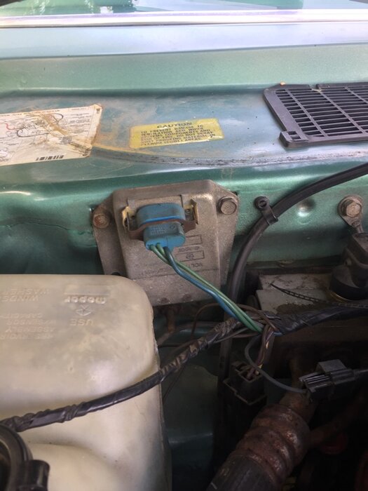

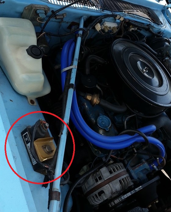

The computer will give slightly better fuel mileage and driveability - but the (firewall mounted) ignition system is simpler, easier to diagnosis (when acting up) and (to some) more reliable.

Just about the only thing that used for both pre/post computers is the ignition coil, pickup coil (in distributor) and wiring harness. Except for JustWondering, most people do not have a problem with the harness (and I doubt her rodents caught up with this car . . . yet).
