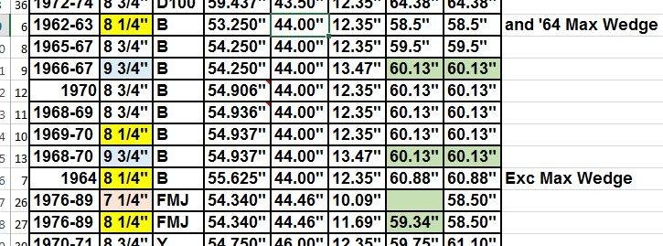

1,485
Header terms:
F – Flange to flange
P – Perch center to perch center
C – Center of U-joint to center of axle length
D – Drum to drum width
T – Track
(Note: green in column D and T is not a 100% accurate number).
FMJ bodies are 44.46” perch center to perch center (column “P”).
’65-70 B-bodies are 44” (0.23” difference per side). If using older shock plates, you can squeeze one into a FMJ without modification (except for possible driveshaft length) – but I would slot the shock plate holes out a little, at least.
’65-67 8¾” are a very close fit.
’68-69 and ’70 B-body 8¾” is somewhat close but wider (allows for a wider wheel – but gotta watch the offset).
