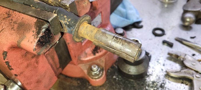

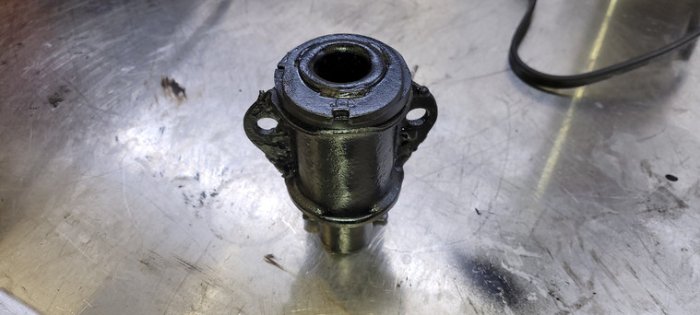

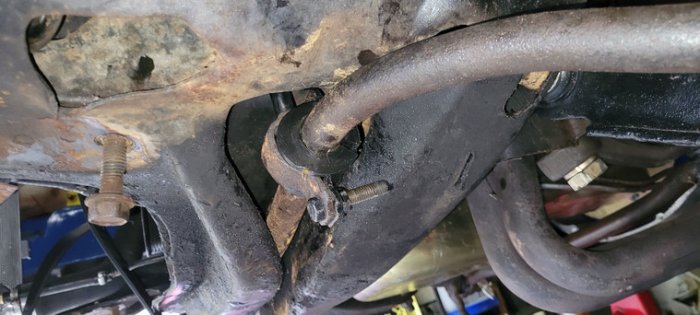

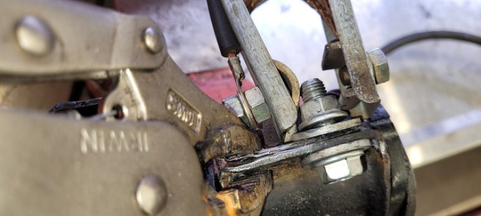

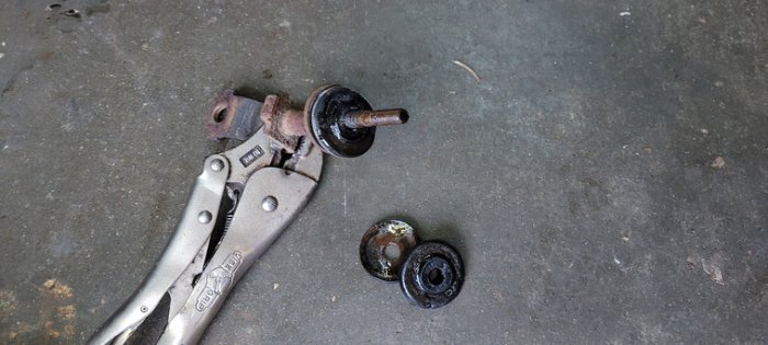

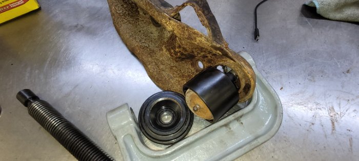

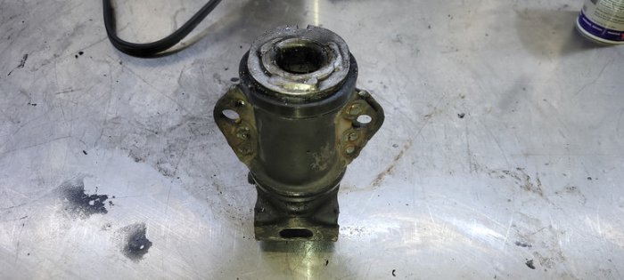

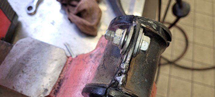

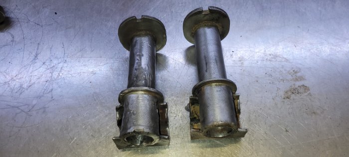

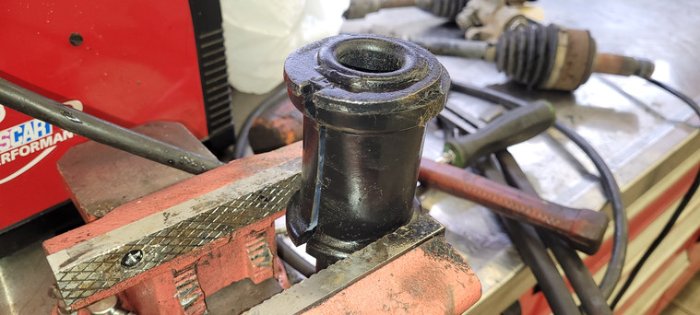

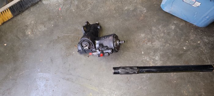

the sleeves need to come off. kinda tight. i hit them with a hammer on a vise base to loosen the sleeve. then ran a screw driver into the split, then removed it.

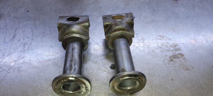

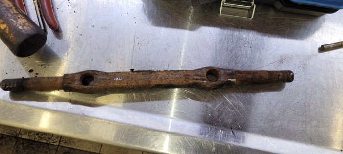

i would love to soak this side like the other in Evapo-rust, but my bucket is dead and i dont need to spend $150 on another bucket when i have way more things to waste money on.
so, wire wheel it is.
