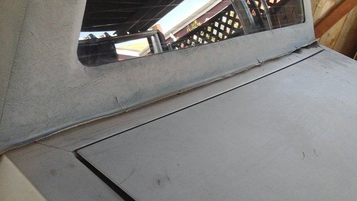

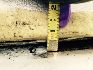

Here is the problem:
There is nearly a 1/2 inch gap between the bonnet and the body of the car just up from the trunk area.
I had to move from the 1/8 inch rivet with a short 1/4 inch grip to a 1/8 inch rivet that has a 1/2 inch grip.
Means I will have to silicone the bottom bonnet edge to ensure water doesn't wick back up under the vinyl/bonnet before I put on the belt molding.

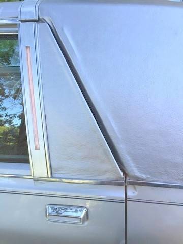

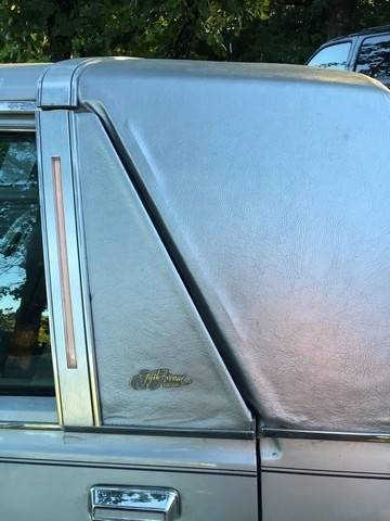

Today I finished installing vinyl covered, opera light wings(?) on each side.
Here is the driver side:
There is one small screw at the top of the door and two rivets under the belt molding (which almost lines up with the rear belt molding- drats).

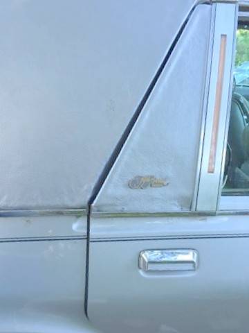

Here is the passenger side:
And yes, all hands came running when I looked at this side and screamed. More than once.

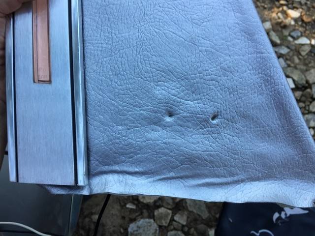

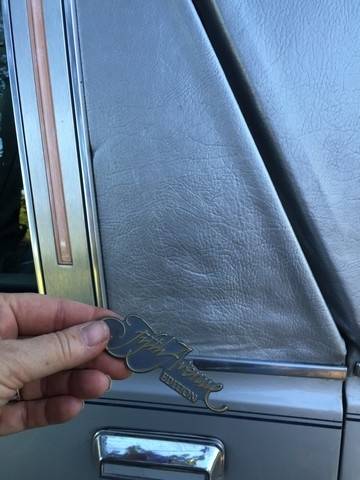

Because, there in front of me is a wonderful-went-to-extra-effort-to-get Fifth Avenue Decal ... which I completely forgot to put on the driver's side before I riveted it to the car.
Well hog fizzle.
So, then I spent another 30 minutes removing the rivets - carefully and getting still sticky silicone all over me.
Holes prepped.
Decal in place.
There is still one small screw at the top and two rivets at the bottom that hold that piece on the car.

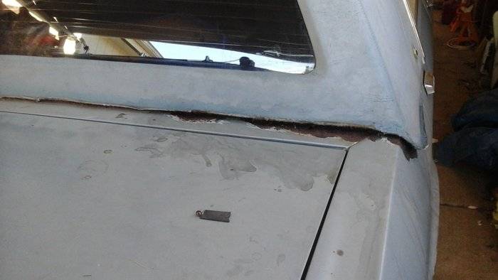

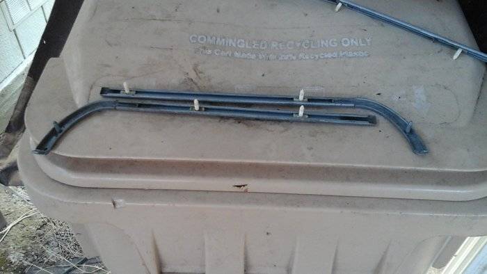

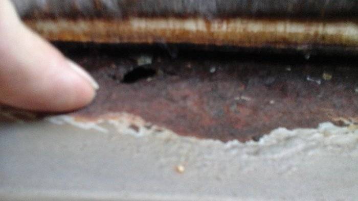

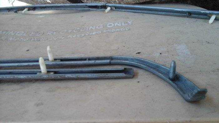

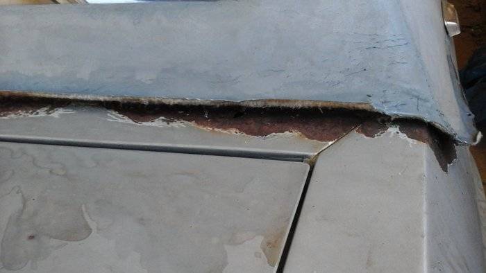

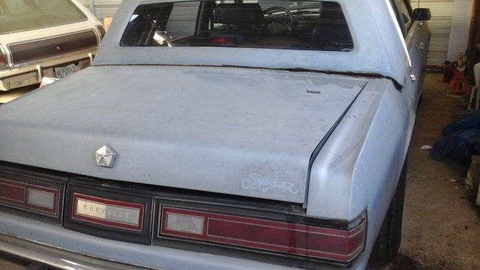

My Los Angeles all its life 5th Ave is quite rusty on its RR corner of the roof cap. A couple of wet years in Portland will do that I suppose. So, my next step is going to be drilling out a few of these rivets and re-riveting with stainless. The rust goes way under the cap's edge so I need to get it lifted up some.
It was nice that the metal trim moulding is a press-in fit though that's probably as much of the cause of the rust as the rivets. Rust has eaten away at one of the holes. For the rust, I'm using Rust 411, it removes rust thru a chelation process, then I suppose I'll JBWeld it up afterward.
Any thoughts on trying to mount the cap on plastic spacers so that this thing will drain off the rain? Like putting plastic washers under the cap at each rivet? I may try that. Some of the rivets don't appear in-line ...even. Hmm.

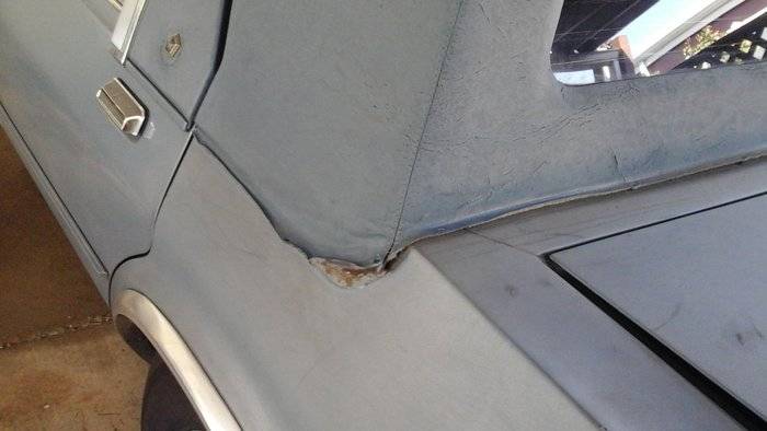

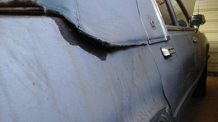

Well this doesn't look so bad......
....unless it's like really bad....
.... like this....

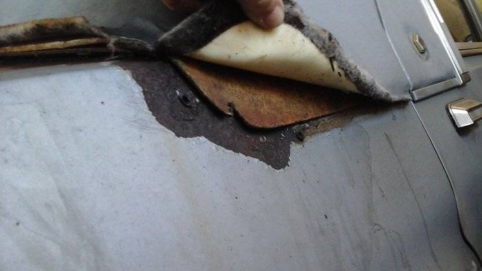

...and it's all the way thru!
Ya, it must have been the ocean air? idk
Driver's side not rusty yet.
Press on, press off.
