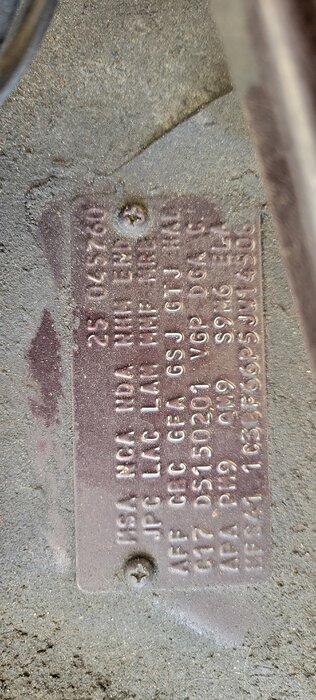

Does anyone know by my fender tag which size rear brakes I have?

The rear brakes are the only ones that could be either 10" or 11" drums. Mike is right though, a Fifth Avenue with 11" rear brakes would be a unicorn. I don't even know if there was an option to get the 8.25" rear axle and 11" drums from the factory on a 5A.
I know for sure though that the fronts are 10". You couldn't get 11.75" discs on the front from the factory in any configuration. If you wanted to upgrade the fronts to 11.75" though it's an easy swap. Only thing you need are rotors and caliper adapters. All of which can be purchased from Dr. Diff. It'll still fit under 15" wheels as well.
2,992
According to the (79) parts catalog, 10" drum is for all except 45, which is 2 seat wagon.

Police package cars had 11. I think taxi might have had them too but by 88 those were also 10".

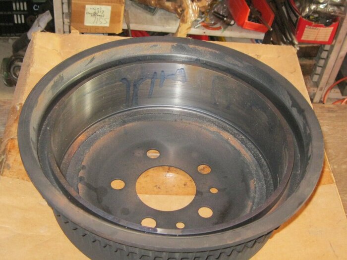

I just checked Feebay for "NOS Mopar brake drum" and the closest thing for an M Body was this, and I don't think it'll fit. It's 10" finned drum for Cordoba. Looks to wide too me like 10x3? and it's only one. I don't have part # in front of me for M bodies but I don't think they cross over for Doba's and M's. This is the first finned 10" drum I've seen. $100 including shipping is a deal IMO, knowing what I know about quality of aftermarket. Interesting.
https://www.ebay.com/itm/314372337485?
2,992
Cordoba also had 2 1/2" wide shoes. The only difference between Doba and F/M/J is the Doba uses finned drums vs non finned for FMJ.
