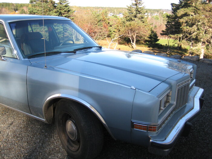

Hello All,
Glad to finally find a forum that caters to M bodies. Mine is a low mileage (142K km / ~88K mi), AHB code (police package), that was sitting in storage for more than 10 years. Mileage appears to be genuine and the car is virtually rust free with original paint on all surfaces except drivers front fender / hood. I assume a minor shunt that left the sub frame and inner fender untouched. Car has the 5.2L (318 w/roller lifters), V8 with a two barrel, 904 automatic and 2.94:1 open rear axle. Picture below (Note, I have a set of the correct stainless steel hub caps with the ventilation holes).
I believe the car was used by a detective as it doesn't have a certified speedometer, external markings or a four barrel carburettor. It does have some unusual options, fender top turn signals, tilt steering wheel, tinted glass and power outside rear view mirrors (both), along with the usual AHB body and suspension upgrades.
The plan is to turn the car into a sort of 'sleeper'. Engine will have ~300HP when finished backed up with a stock torque converter, 4 speed overdrive automatic (type 46RH), and a 3:54:1 SureGrip rear axle. I'm 1 year into the project and have collected the majority of the parts but still need to chase down a few big ones; camshaft, automatic and rear axle bits. Hopefully a year from now the car will be ready. Fingers crossed. :)
Thank you and take care,
PK

Looks nice!
For some reason Canadian ones didn't say Certified on the speedometer.
The fender top turn signals weren't around past 80 or 81ish so they were added. 88 and 89 had power mirrors, I'm not sure if you could get them in those years without them?
DCAspen
Sep 27, 2011
1,456
361
ct.
No US made 80 F body had fender blinkers but Canadian 80’s did.I’ve had multiple US 80s and they don’t even have the wires to add fender blinkers

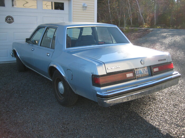

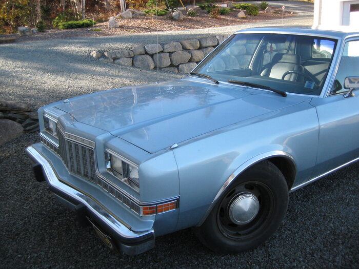

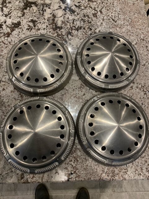

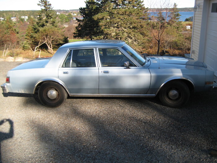

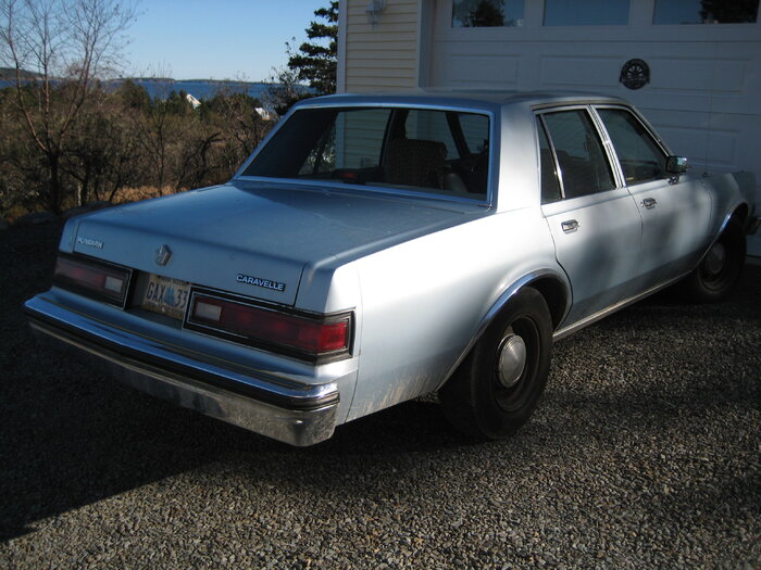

A few of you requested more pictures. No engine pictures - it is absolutely filthy having sat in a barn for ~11 years. I added 6 pictures (hope the server allows it), including one of the proper dog dish hub caps I just bought.
Please bear in mind this is a long term project and I'm making MANY changes. For example, I removed the complete interior to add heat / sound insulation, carpet, headliner, seat belts (incl. rear outboard shoulder belts), new stereo, keyless entry / power door locks, power windows and bucket seats. I haven't even started on the suspension or drive train. However, I have collected most of the suspension bits and some of the engine modification bits. Still need to track down 46RH gearbox (Duke5A, thanks for the heads up :), but I just found a guy with a new 3.55 gear set (USA Standard), and a new limited slip diff (Yukon Gear). Not cheap but used stuff is always a big gamble.
If you have any questions, you know where to find me.
