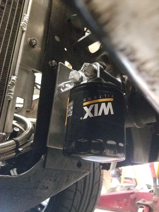

- Remote mounted the oil filter behind the bumper

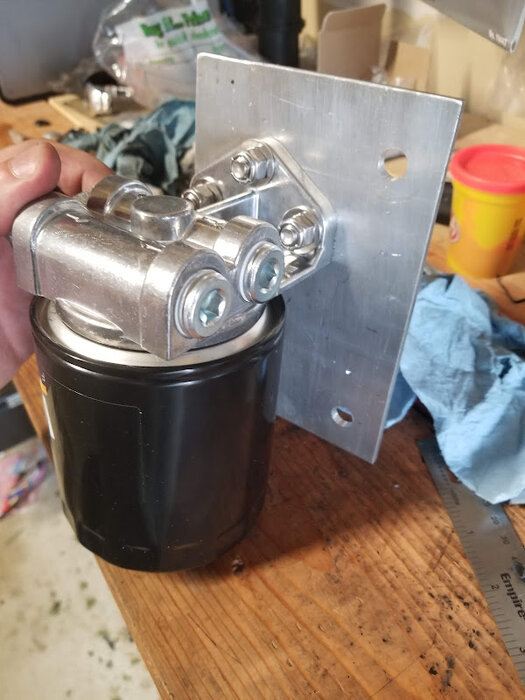

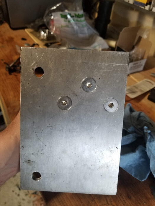

The oil filter relocation is a must with a big block in these cars. What a massive, messy pain in the ass it is to change the oil with it hanging off of the oil pump. Power steering and battery tray get in the way. Not anymore.... Still need to plumb it though. I just changed the oil a little while back and figured I would plumb it next time I change the oil. The plate the filter adapter is attached to use is bolted to the car using the bumper bolts.

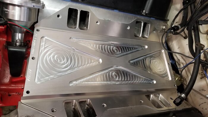

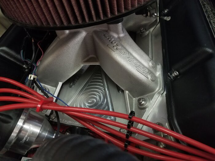

The solid valley tray is a piece from AR Engineering. Got quite a few of AR's parts on my car.

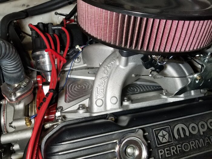

Intake is a single plane Trick Flow. Single planes don't seem to lose any low end torque over a dual plane when used on stroker motors, or at least nothing the butt dyno can feel.

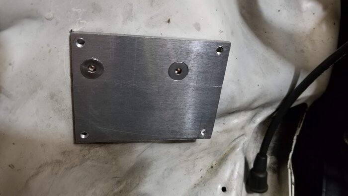

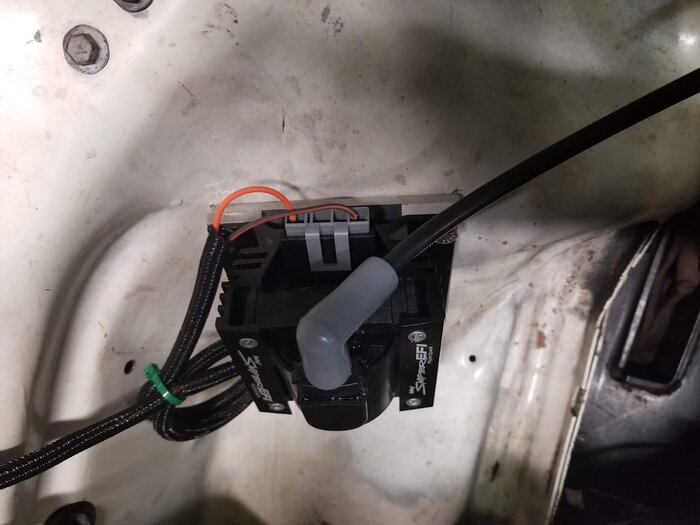

The coil took the place of an MSD Blaster II canister type. Needed to make up a plate to mount that to and use the original holes in the fender to mount the plate to.
The Holley ignition box is the same width, but shorter than the MSD 6AL it replaced. Not wanting anymore holes in the car I mounted it to a piece of flat stock aluminum and in turn mounted that using the existing holes in the fender.

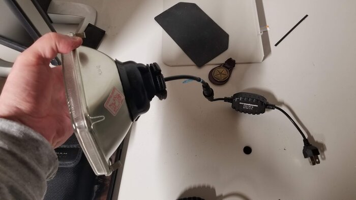

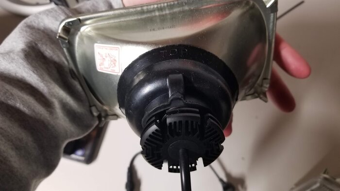

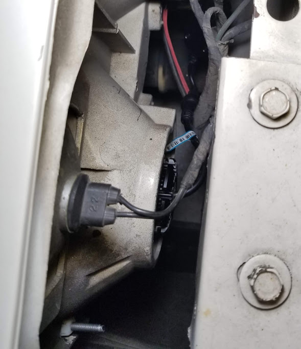

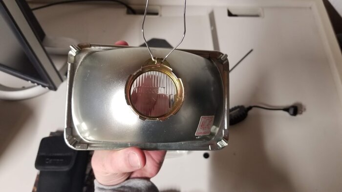

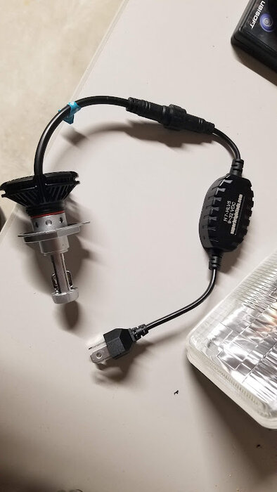

The headlights are a bit weird. It's a conversion on a conversion. I'm using 4x6" to H4 housings and H4 to LED bulbs. The housing aren't that bad for what I payed on eBay and the bulbs I got off of Super Bright LED. The difference in night time driving over those old halogen bulbs is crazy.

I've written about this before. The oil filter is in a tight spot. I hadn't thought about it in front of the core support - but that will work.
I'm still going to place mine at this location: 383, A sense of direction post # 22 (oil pump adapter) and 30 (filter location).
It is a bit more hidden but still accessible when under car to drain the oil. Still have plenty of room to run the hoses.
For the automatic, making a similar bracket for a remote transmission filter - but on passenger side (under fender).

Can you make a couple of updated underhood pictures once back together and running? Also of your headlight conversion after it is complete? I didn't think there was room for all of that behind the bulb.

I ayreen a two plane intake is not needed with 500 lbs of torque off idle, the single plane works better with EFI also...

There is actually plenty of room for those LED headlights. The heatsink is barely visible from the back of the bucket. Still have figured how to mount the inverter though.

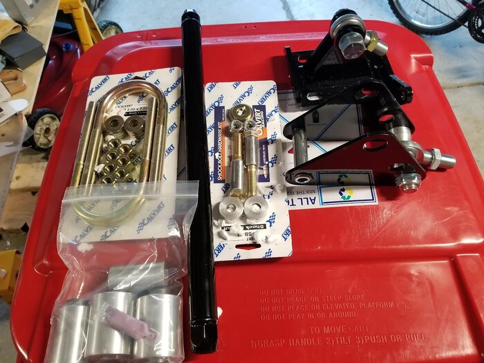

Got a birthday present from Dad! Won't be installing this year though. Out of time now.
