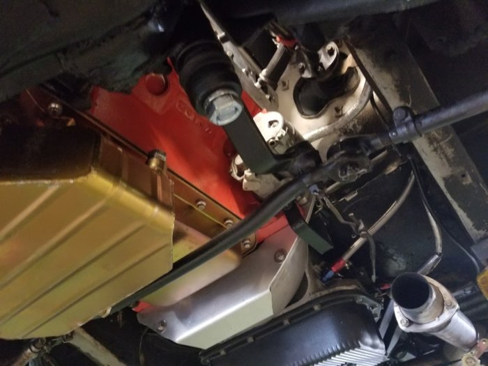

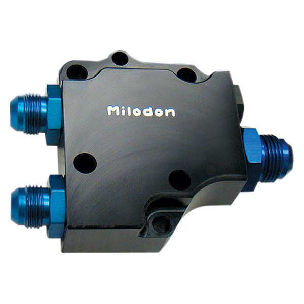

One of the items I don’t have worked out yet, is what to do about the engine oil filter. It is impossible to change a big block oil filter car from under the car. The battery (if applicable), torsion bars, P/S pump (if applicable) and radiator hose (if using a Right exit water pump housing) can make regular oil changes a pain. I’m thinking about fitting an external oil filter to driver’s side inner fender area using an oil pump housing like this:
Then incorporating an automatic transmission external oil filter setup on the passenger side inner fender (a mirror of driver’s side) – but that is a different topic.

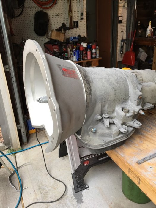

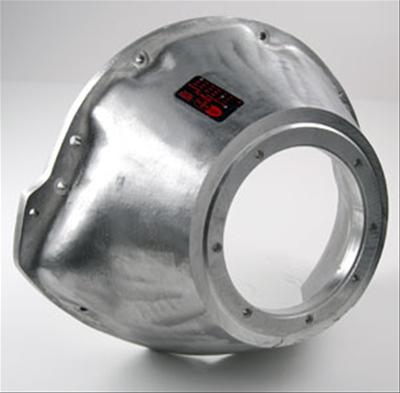

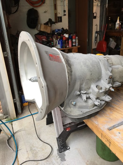

Am I understanding correctly that a A518 can go behind a big block if the JW performance bell house is used? I’d much prefer a a518 over a 727 if that’s the case/possibility. Extra gear and OD never hurts. I guess that would now make my next question: would a a518 hold up as well or better than a 727? While I don’t plan on running the drivetrain super hard, I definitely would like something that can handle a good stab of the gas pedal on the occasion.

I have to remove the fan and shroud to change the oil filter in my car. Could do it by removing the battery and tray but the other way is easier (and lighter on my old back than a battery, lol). Not a huge deal since it's only a once a year winter operation but, it is a project.
I've got a 440 Source passenger side outlet pump housing so I don't need plumbing running across the car from one side to the other. It does get in the way of the timing tab though. I marked TDC on the pump housing so checking timing isn't a problem with an advance timing light.

A 518 is a 727, just with an additional gear. Been living behind my 512 for the last couple of years now happily as a street machine. The Ultra Bell works well too - installation will make your ass pucker a little bit.

There have been quite a few people at FBBO and FEBO using big blocks behind the A518 w/Ultra Bell.

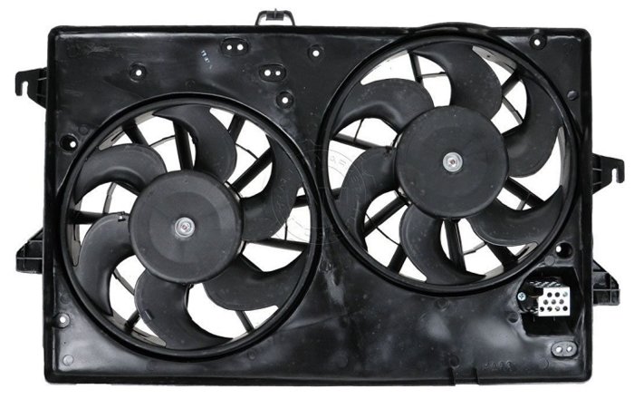

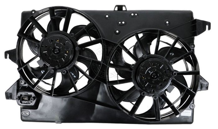

Note: I will be going electric fans and that is something I need to do before swapping blocks.
The three possibility’s I have so far are:
1995-2002 Ford Contour Fan (they make a single and dual motor version).

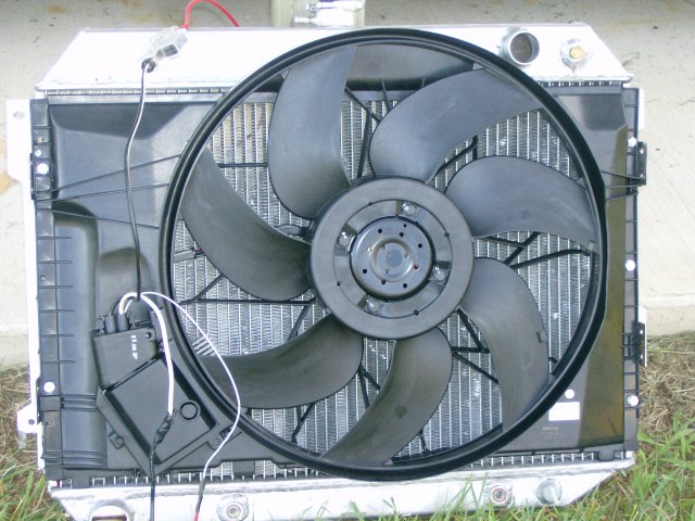

2001-2007 Mercedes C-class
In an A-body (but should be about the same in an FMJ)
New style Charger/300 (no pictures yet, but there is a recent thread about it in our forums).
I need to spend some time at a pull-a-part – but not done that yet. I would rather have a dual fan setup so the water pump & pulley is not in same location as fan motor will be at.
The Mercedes fan will require a special setup to get fan to work correctly (more electronics to hide). Not investigated what is needed for either the Contour or Charger fan motor (yet).

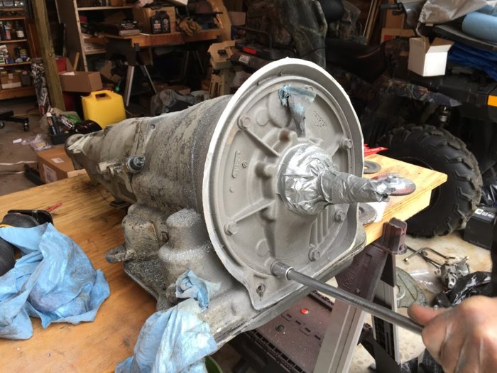

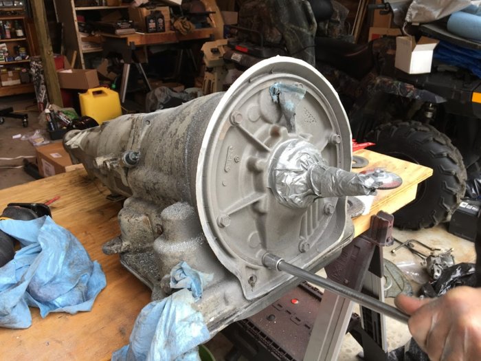

What converter do you use?
That's kind of a long story. I'm running a Turbo Action 17809ST designed to fit a lockup input shaft, but lacks the lockup internals. My 518 is a lockup 3-wire unit. I originally ran this converter behind my 360 and decided to give it a go on the 512 as it's advertised as a tight converter. On the street it drives great and I don't have any issues with part throttle response seeming spongy. On the chassis dyno though the motor torque curve lacked the distinctive broad flat curve stroker motors are known for. After a lot of back and forth the consensus is the motor is driving right through it. Need some track time to confirm, but as far as street is concerned, it's great. Transmission never gets hotter than 180.

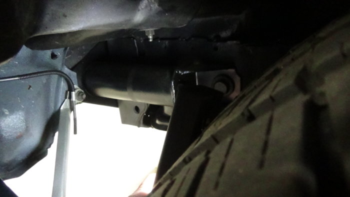

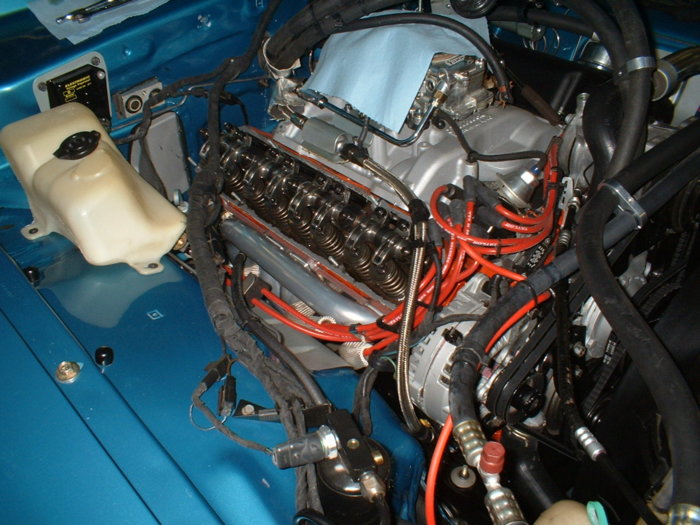

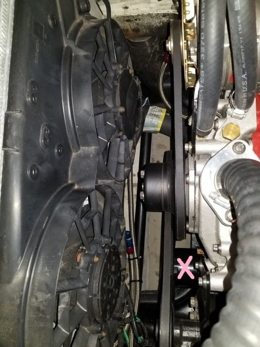

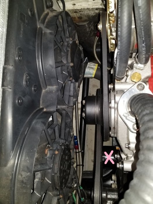

A big block in an FMJ. The pink X is the oil filter.
Bud, that's my car. I can't recommend this setup enough. Has no problem keeping the motor right at 180 degrees on a hot summer day with a three row, 26" Champion radiator.
You're fueling injecting the car, right? I have a Holley Sniper driving the low and high speed on that fan. Just need a couple high amp relays for the two speeds and a 60 amp wedge fuse to protect it.
Got the idea from a Moparts member. Somewhere he has a really nice guide for setting the entire thing up. I can try and find it if you want.

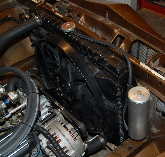

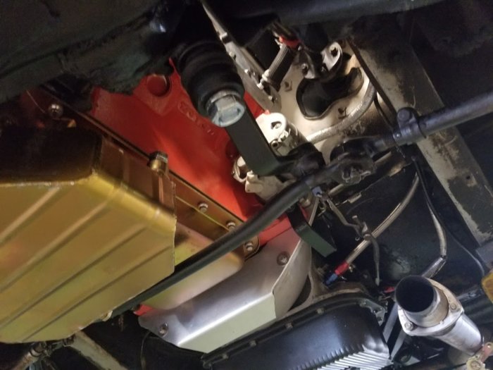

Bud, where you show putting a remote oil filter near the front bumper "shock" is exactly where I had the one on my car in it's previous configuration. I had a dual filter setup but that's kind of overkill (JMO). Since I only manage 1,000 miles or so per year (mostly weather limited), I can put up with the filter changing hassle every loooooooong winter season. Gives me an excuse to clean areas you can't get to with the fan and shroud in place.:D

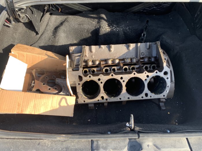

In the bag; err the trunk rather.
The KYB gas a just shocks don’t feel too bad on the rear end with an extra 330lbs in the trunk.

“If” it will be a while before you can do things, put the block (and other engine parts) in a thick plastic back to protect it from moisture and from varmints. I must bag (or vacuum bag) stuff because of the high humidity here for things will start to rust very quick. I can’t tell you how many thousands of $ I’ve lost because of rust even when items are well away from the weather.

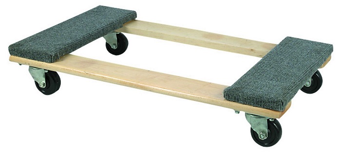

I have 4 engine blocks on (cheap ($10) Harbor Freight) hardwood dolly’s (one each) that have been oiled down and bagged using engine/block bags. The blocks are laying transmission side down and are easy to move around that way. I’ve purchased a few engine bag sets (entire engine, block, crank, heads) for about $15 (or so) that are thick (4 mil).
If not sure what is or where to get engine bags, go to someplace like Summit and search.
You don’t have to answer this, but you didn’t put that block into and out of your trunk, by yourself, did you?
Camtron
Apr 25, 2019
2,278
1,853
US
Oh god no. Engine hoist going in the trunk, engine hoist coming back out.

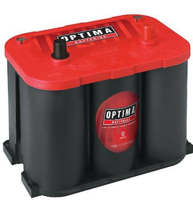

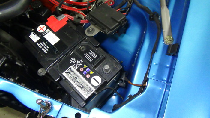

Even in the trunk of a coupe or sedan, you should use a battery with provisions for a vent tube to the outside. There are a lot of batteries like that now since a good portion of newer vehicles have the battery in the trunk, or under a panel in the floor, or under the back seat so one that works shouldn't be a problem. I actually have a battery for an Audi in mine with a vent tube running down under the car. That way all the battery fumes won't cause any corrosion problems. Why an Audi battery? Well, I worked at the dealer at the time and they're EXCELLENT batteries that easily last more than 10 years, no problem. It's now 8 years old and load tests as new yet. Yes I know, the terminals are reversed so sue me.:D
