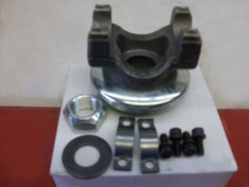

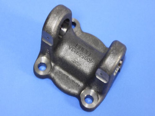

Different topic, the propeller shaft flange/yoke changed company-wide in mid ‘90’s, to a flat flange/yoke.
FMJ style differential yoke
New style differential yoke
The propeller shaft end (flange) that attaches to the new style yoke.
The flange/yoke will easily interchange with any of the older yokes, as long as it is ’70 or newer (29 spline) for any 7¼” thro 9¼” and including Dana 60/70. The ’68 and older yokes are 10 spline and will not fit.
All FMJ’s came with 7260 U-joints.
If a person is needing to get a propeller shaft made, or modified, and also needs a yoke – I would encourage you to upgrade the yoke and U-joints to 7290 or to 1330 style joints – if your car makes a lot of power.

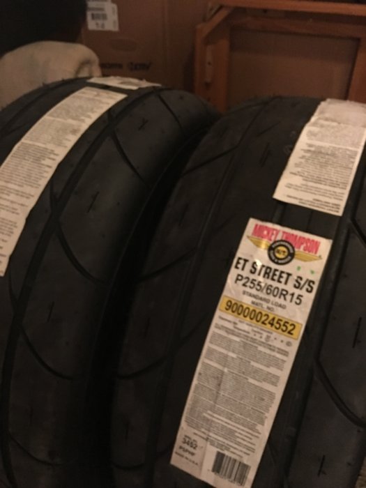

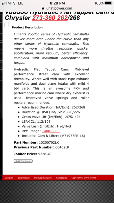

This is great advice Old Iron! Thanks! I’m running cop rims with 255/60/15 Radial TA’s and have 255/60/15 Drag Radials in the basement right now. Run them at the track, here’s cam specs.

I was going to say that's a nice street cam, the spec's are similar to the old hemi grind cam that mopar sold. I've use that in several 440 projects and I have a buddy that ran it in his 340 Dart for years.
It would be nice if you would post information on your motor build, you must have had it run on a dyno to come up with the numbers you did, post them. A good converter and gear your car will be a blast.
