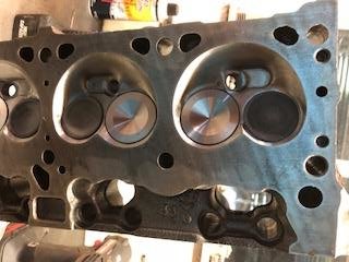

Okay . Kinda thought it was around 73ish. For what it's worth I got a set of dart heads that's suppose to be after market x heads . Chamber looks a little smaller. May work for ya.
