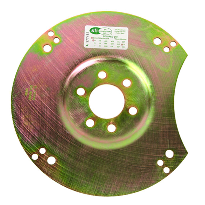

The 360 requires a dedicated torque converter OR aftermarket flex plate with the weights on it for external balance, Otherwise, it's a drop in going 318 to 360. The pan only needs changed if the 360 is from a truck. They have a rear sump and cars are center sump.

- The newer 340’s and all 360’s use externally balanced harmonic balancers and torque converters.
If you use the correct balanced torque converter (for either A904/998/999 family or A727) then you will be fine. In my opinion, if a person needs to obtain a torque converter, it is better to get a balanced flexplate then use a 318 converter and just eliminate that hassle.

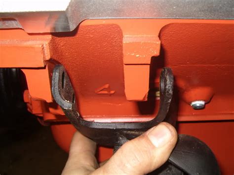

(center sump) small block oil pans are all the same - except between 273/318/340 vs. 360's.
Pickup oil pans are rear sump and motor home are front sump - so neither will fit a car. They also have 273/318/340 vs. 360 versions.

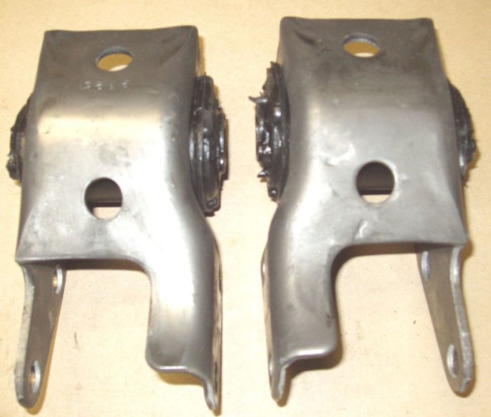

When (if) looking for engine mounts - you want to look for spool mounts.

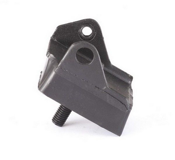

Older (non-spool) car mounts and trucks/motor homes do not use spool mounts.
Older car type mounts (both halves) - which will not fit any FMJ car. Truck mounts are also different.
