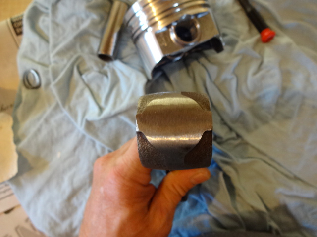

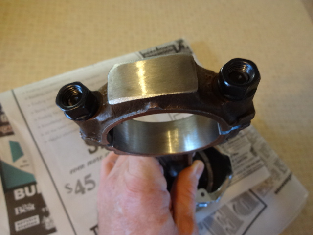

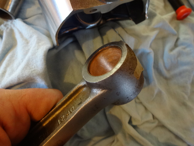

They started out as 30k mile std 340 rods and I copied what DC did to there race prep rods (not there oval track heavy hemi style rods) just lightened to within 15 grams of the thin 273/318 rods, magged, shot peaned and polished beams, rebushed and resized with arp bolts.

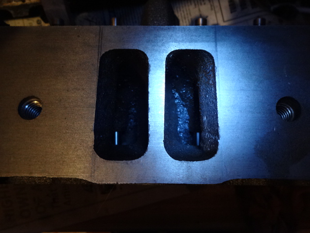

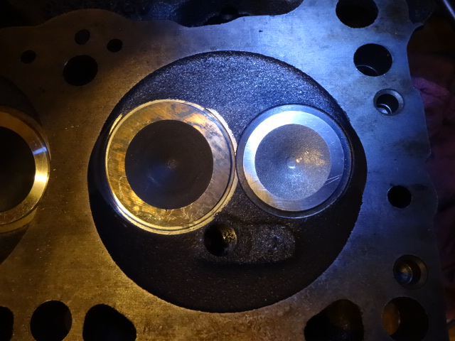

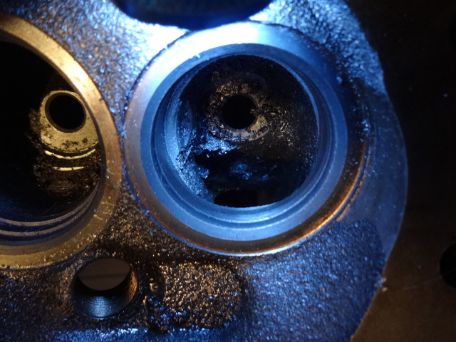

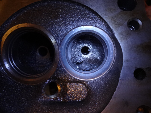

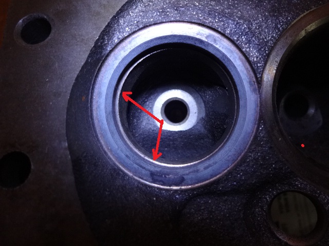

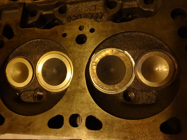

I finished the upper 1/2 inch of a intake bowl today and need to clean up the one cut you see in the chamber (go a bit deeper to the same level as the oem cut. I also cut the upper ex bowls to match the hardened seat inside OD because as you can see in the pics they were not very concerned about some of the machine work that didnt matter.
I got them with a few thousands and can sand paper roll them flush, I can cut these on my mill faster and easier then I could by hand and will clean up what I need to by hand.
I looked over my org. heads for this motor and in addition to no hardened inserts there looked to be no advantage to use the older 100k mile casting that id have had to put guides in.
Ive alot to clean up on the intake runnes since these are the same castings used on the roller cam heads but with the smaller non roller holes for the pushrods. But it will be easy to get them to the older, bigger oem 318 runners and then go some more, the line in the pics is where the edge of the pr rod runs so there is alot to remove and then some of the devider.
Im not going to get too carried away just whatever gains the 1.78 to 1.88 bring and intake runners, a bit wider on the throat, short turn bring is all im doing. If I wanted to do more id just use some 2.02 J with almost nothing done to them.

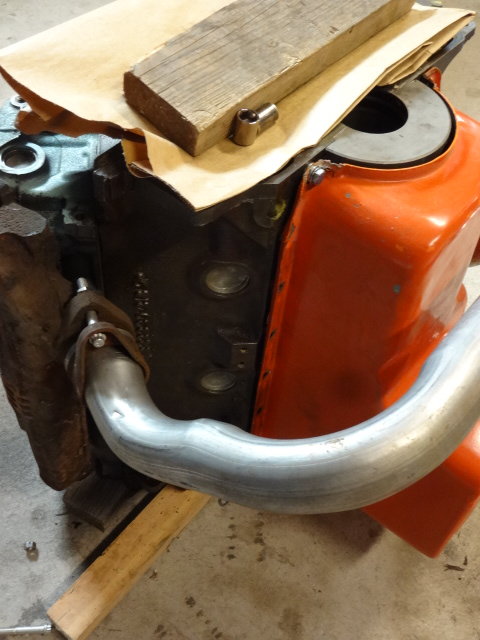

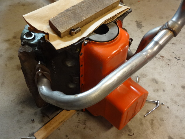

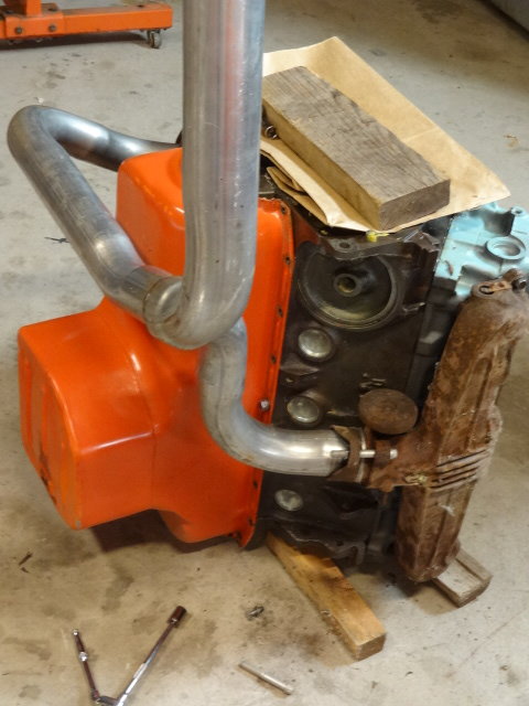

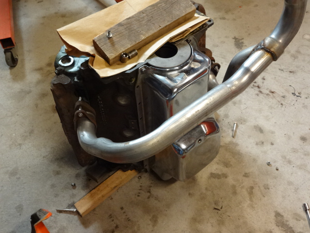

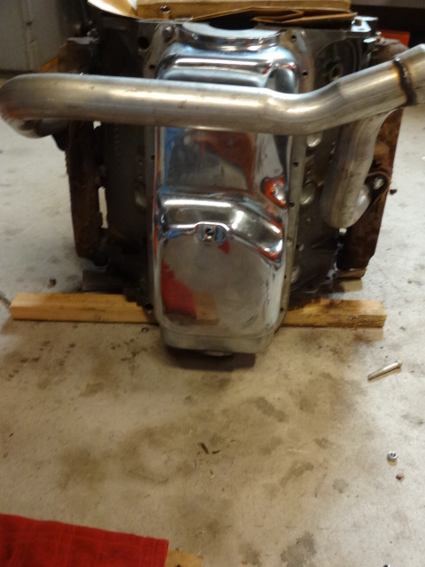

But a good fella here sold me a Y pipe he had made up that was substantially bigger then oem and sine im going to run the oem but cleaned up a bit here and there org. to the car ex manifolds I tossed up a 318 (dippy roller block and new heads, anyone looking for a 318 roller project, let me know ive alot, all the new parts to dump).
Ive a nice full system and a cool muffler to run a stealth single ex. system.
I dont know wtf I was thinking but since I dont do much oem like stuff I didnt think I could mock this up on the real 318 itself thats on the stand, seems I could of.
Although this is a bit better then stock stealth build it looks like the bigger capacity oil pan will work and since the car has deep gears and will run warmer then some others I probably will use it.

The hardened seat install looks familiar, cleans the bowls up nicely.
1,492
Looks sharp!
Quite the mixture of colors: orange, blue, black, stainless, rust and chrome (and yes – I know its only a mock up).

I wish I had a reason to build that one I tested the y pipe on, its either more parts laying around or one big pile of parts laying around. Both not good.
