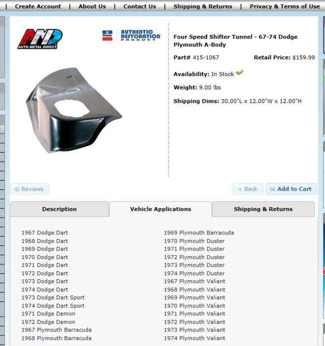

GM are entirely different. Id get an A body hump from amd. That's the closest your going to find. It doesn't look like theres a big difference with an F tunnel. The 75-76 is perfect if you can get one.
1,494
http://www.autometaldirect.com/amd-four-speed-shifter-tunnel-67-74-dodge-plymouth-a-body-p-2683.html
I know the ’66 and down A-bodies are different – but would think this would be the same as ’75-76 A-body (but not an A-body expert to know for sure).
This A-body part doesn’t look right for an F-body – but without one to look at, I can’t say for sure.

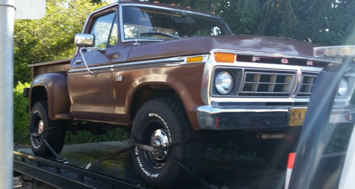

The "new" 390 goes in this:
C'mon... even Mopar guys like a 70s Ford truck (TBH, I was actually looking for a similar P/W when this thing fell into my lap. Like the Lebaron, it was too good to pass up)
