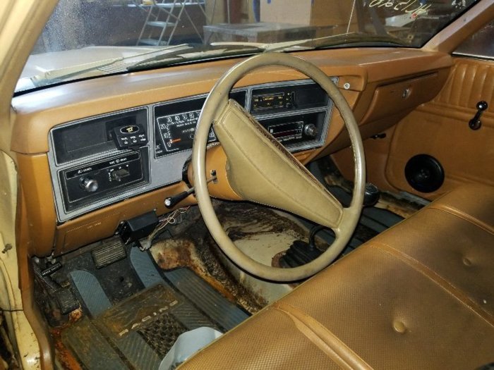

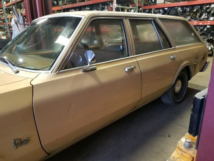

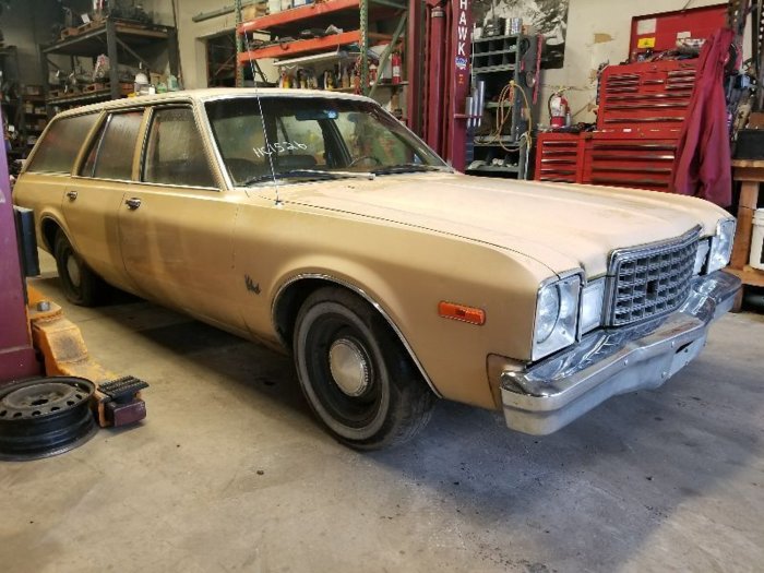

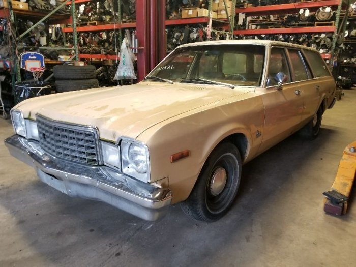

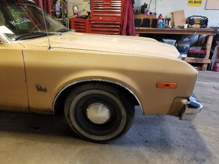

Aggghhh!!! I hate to see this old '78 plain jane volare 4 speed being parted out!! It looks quite decent from the pics that are available. It's on EB: Manual Transmission 4 Speed Fits 77-80 ASPEN 429476 | eBay

I contacted them. They are a tow/salvage yard. Apparently the car is completely rusted through the floors/frame rails. I wanted the 4 speed hump.

I'd also like to have the hubcaps... they look to be in good shape.

I was told the hump is rusted through. I bought the pedals from them, very reasonable price.
