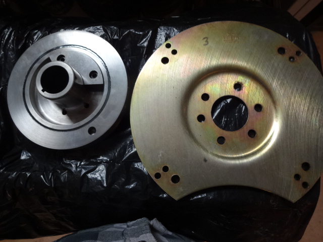

Ok, so what parts do I need to take to the balancing man, I have these parts
Mopar SB 318 340 360 7.25" Harmonic Balancer Damper small block Chrysler - Has a bolt in weight
B&M 10239 SFI Flexplate for Chrysler 71-92 Chrysler 360 w/TF904
A standard finger type flex plate
Plus pistons, rods, bearings, rings etc
and
I have the 360 Magnum flex plate with balance weights on it. But I don't have a 360 Magnum Harmonic Balancer.
My Torque converter has no weights on it, so what I want to know is do I get this mopar crank balanced to the old LA balance or the New Magnum balance if I can't internally balance? (which means I will need a 360 magnum harmonic balancer)

Id take your guy this, leave your magnum parts at home.
B&M 10239 SFI Flexplate for Chrysler 71-92 Chrysler 360 w/TF904. He might spin it with no flex plate just for kicks of hes not done one like your before and he should know you have a(non weighted vert).

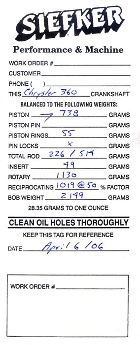

Take a look at the attached balance sheet for when I build my current 360 small block.

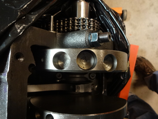

I went the route of external balance but using the 360 specific B&M flexplate, no weights on the converter and additional balance weight on my Coyco dampner. The rod big & small ends were balanced to within 0.5g (heaviest to lightest), see below:
SMALL END BIG END OVERALL
226.20 513.60 740.00 Lightest
226.40 513.80 740.50 Heaviest

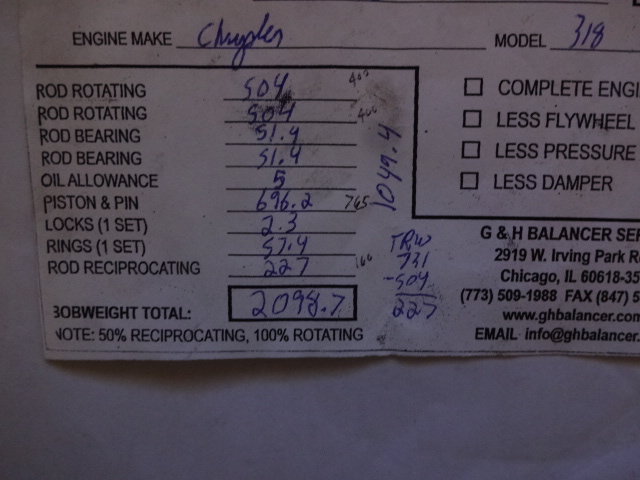

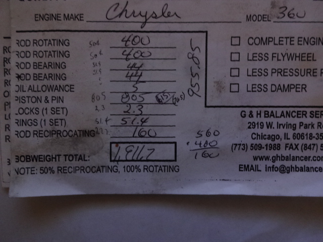

This is from a heavy piston/light rod 360 ext balance, middle ground of a 360 la/360 mag.
Never mind the side notes, I was just subbing numbers.
Most cookie cutter internal forged strokers have a 2150 target weight on the crank and end up slighty under (drilled).
This 318 ended up being just a bit lighter then a thin rod 69 oem 318 at oem 2147
This with lightened 318 rods and kb hypers ended up at 2098 internal.
