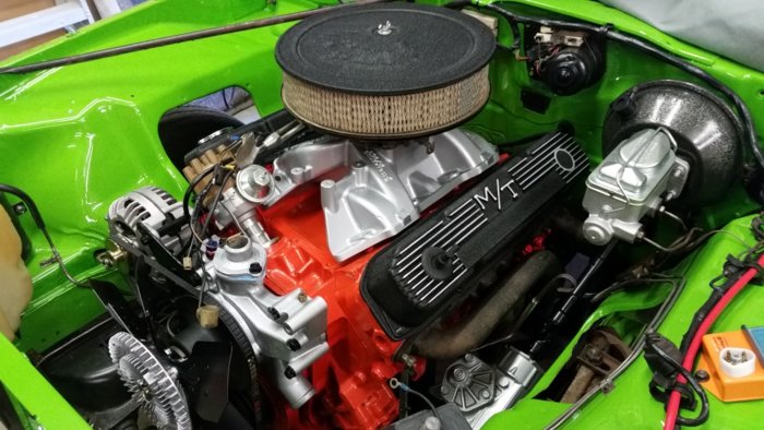

power brakes are not an option with a 440 in a F body

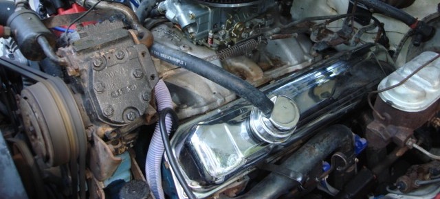

Thats crazy talk buddy, the 2 I did had power with zero issues using a non F booster and if youd explore this site you will find several more.
A 440 in a F with power brakes is a no brainer. Id think more then most youd think out of the box. Not a good pic but notice how the edge of the booster fits behind the VC.
modelmakerinc
Jul 20, 2016
42
3
South Florida
Ok, you proved me wrong, but the valve cover in my car with 383 barely squeezes by the booster, there is no way to service the valve train with RB and power brakes.
Or am I wrong about that too? Or if I go to a stamped original style valve cover would help.

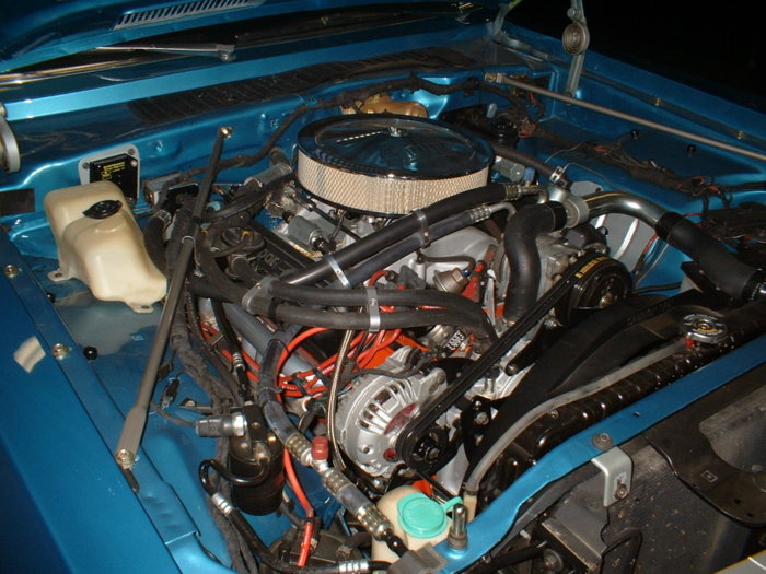

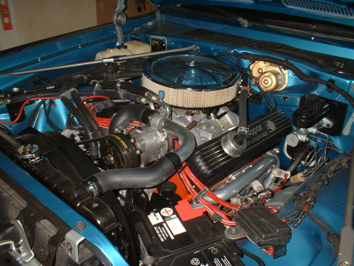

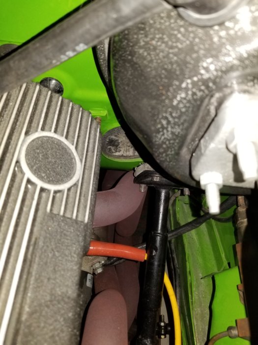

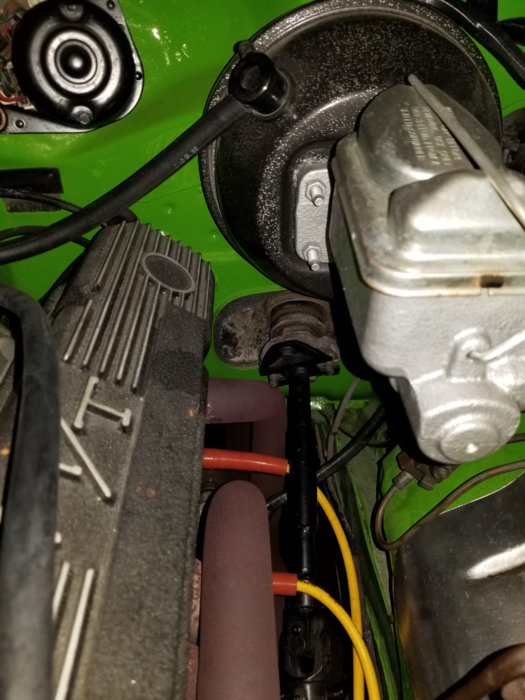

My 2 cents worth is, with an RB and cast valve covers, a small booster would fit (just) in theory but getting the cover off could be a problem. With A/C you have to discharge the system and unhook the evaporator lines to get the right cover off.
The Schumacher headers fit like a champ with zero issues. Left goes in from underneath with the steering shaft disconnected, right side drops in from above. Not as ideal maybe as long tube headers but on the street, I doubt you could notice a difference. My car has no issues with a rag joint since it never had one as long as I've owned the car (32+ years). What the shaft is from, I have no idea and until being on this forum, I never knew all FMJ's had a rag joint.
For those who think I never drive the car, proof is stuck in the condensor in the form of bugs, so there:p
