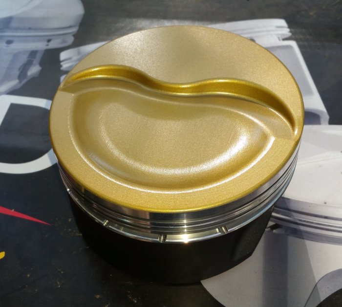

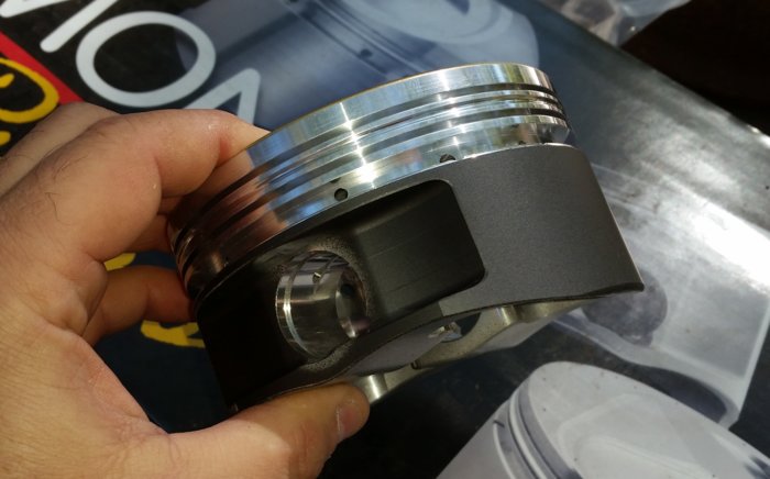

My Diamond are coated, ceramic on top and moly on sides.
