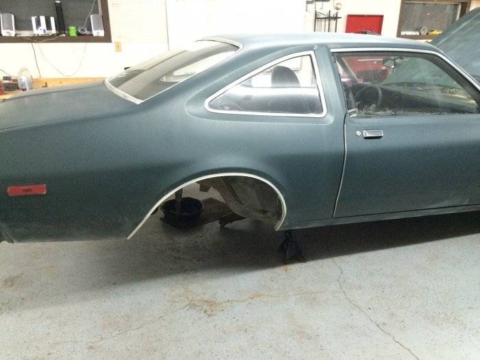

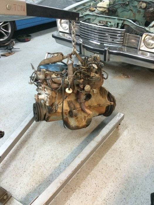

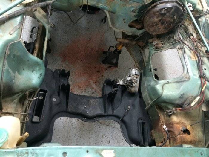

    Hey guys and gals -
    Here are some photos of my car from when I got it up to last night. Sort of a time line of photos.
    beatersRus and MiradaMegacab like this.

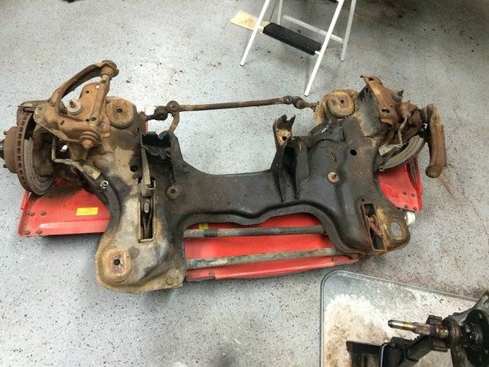

    Minnesota

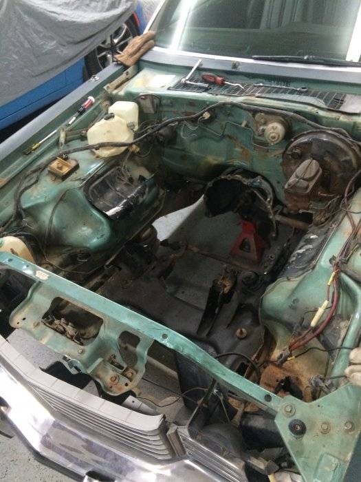

    more

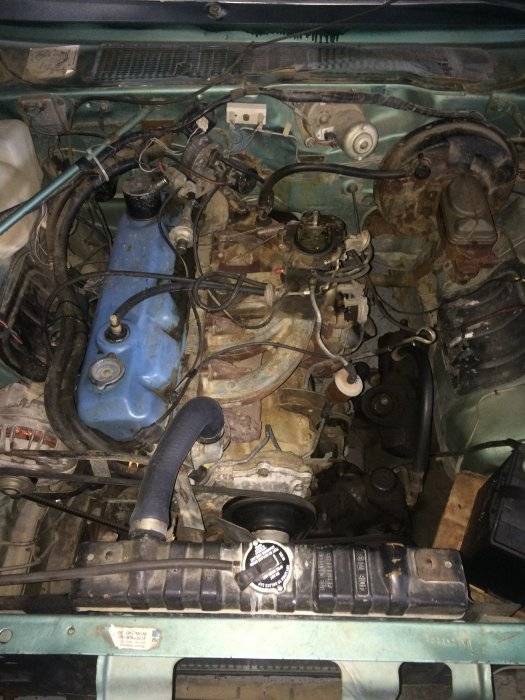

    Minnesota

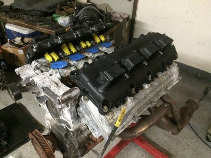

    more
    MiradaMegacab and Monkeyed like this.

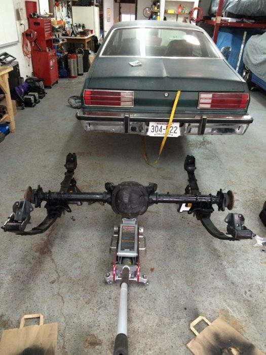

    Minnesota

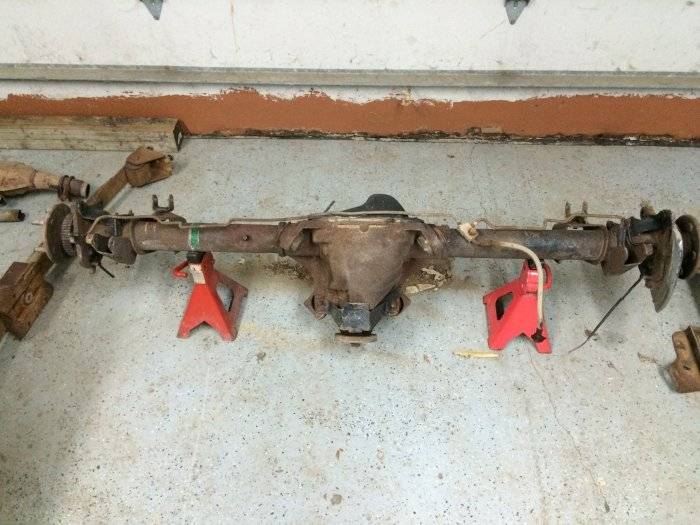

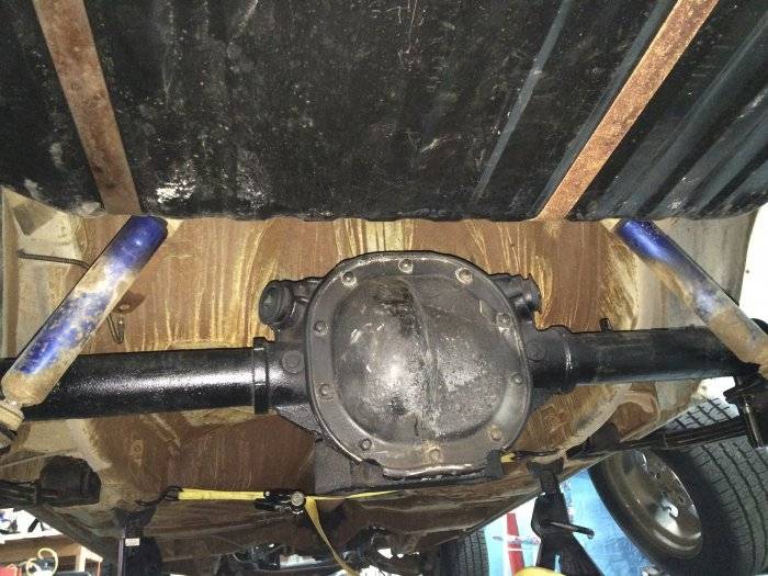

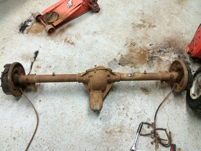

    yes it is. Its out of 97 Mustang GT
  6. slant6billy
    slant6billy Well-Known Member
    2,879
    578

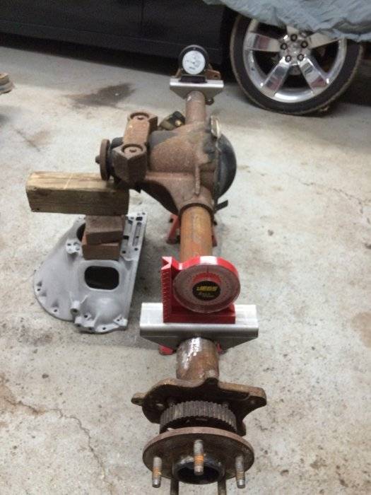

    what is the width? and do you gain back space?
  7. jbuhr
    jbuhr Member
    20
    17
    Sep 20, 2015
    Minnesota
    The 97 Mustang rear end is .75 inch wider than the stock rear end. This works out well to use a little wider wheel/tire but not run into the leaf spring. Not much different, but some.

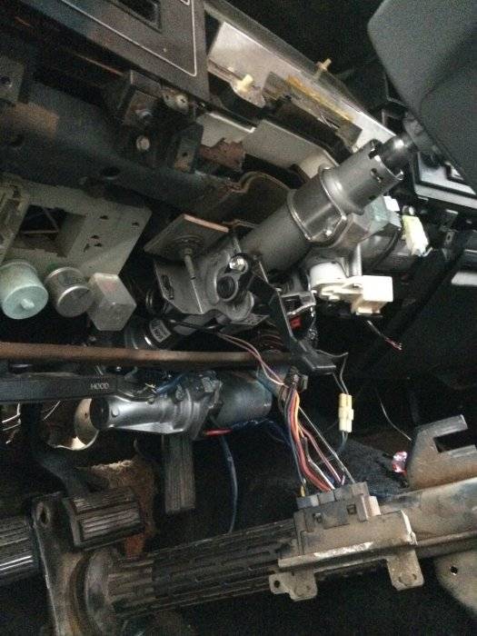

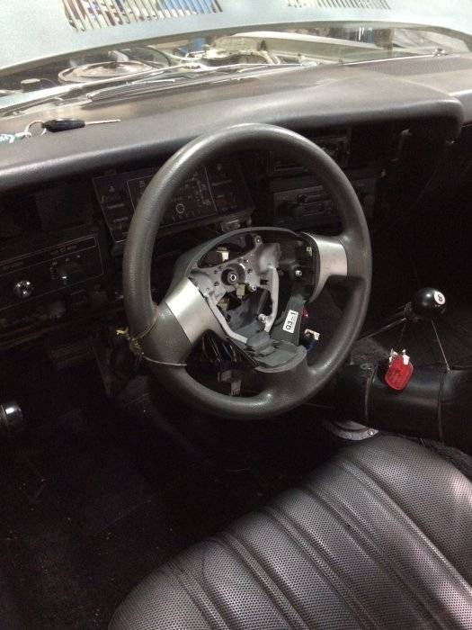

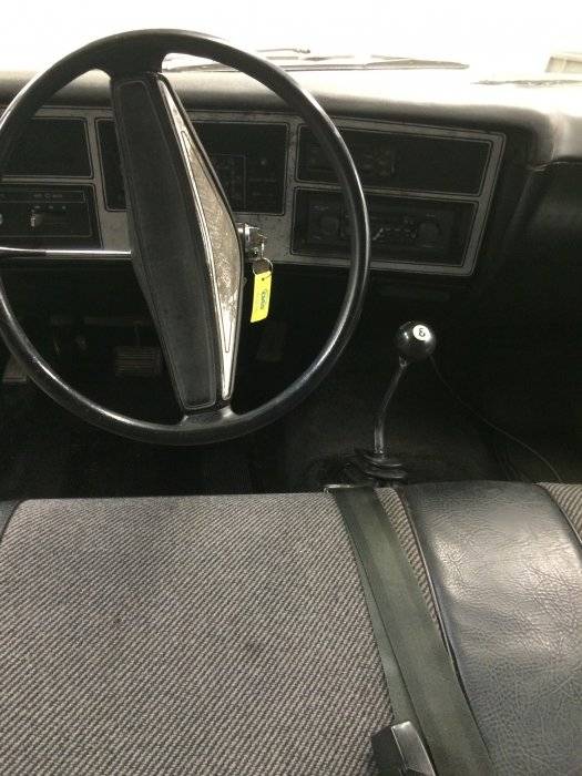

    What is the electric power steering column out of?
  9. jbuhr
    jbuhr Member
    20
    17
    Sep 20, 2015
    Minnesota
    Ah! Someone noticed. It's out of a 2009 Corolla.
  10. Dr Lebaron
    Dr Lebaron Well-Known Member
    2,772
    591
    Aug 17, 2011
    Islamic State In Canada
    That electric power steering column swap really impresses me.

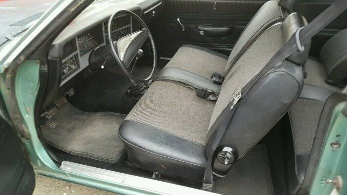

  13. BudW
    BudW Moderator Staff Member
    4,326
    1154

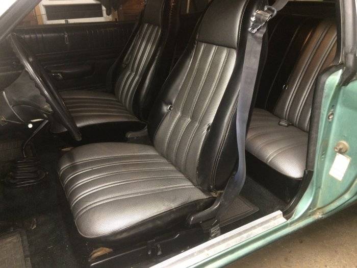

    I like those seats!

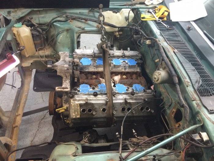

    Some questions I have on your “changeover”
    - Using a /6 or small block K-frame?
    - Going to get rid of rubber K-Frame biscuits?
    - Any other suspension modifications?
    - What ignition (or fuel) system are you going to use?
    - Are you going to retain the 18” wide radiator, go to the wider 26” radiator, or something else?
    - I understand going with power steering (cool idea with electric column) – but are you going to get a faster ratio gear? Manual steering gears are rather slow. Power assist on a slow gear will be very easy but still slow to turn steering.
    - What transmission do you plan on using?
    Thank you,
  14. jbuhr
    jbuhr Member
    20
    17
    Sep 20, 2015
    Minnesota
    Car was a slant six but I put a small block K-frame in it. This way I could use the available motor mounts from Schumacher.
    I'm going to be ordering poly replacements from Spring n Things.
    I will be welding torque boxes and subframe connectors in once the car is "on its feet" again.
    I will be using the EFI Source plug n play harness and Gold box with an inline Walbro fuel pump. I may need to install a sump. Not sure yet.
    haven't gotten that far yet.
    This most likely will be temporary. I'm going to be researching manual steering racks. In fact, a Dodge Omni manual rack may work. I own a GLH-T. I will be measuring this summer (when the GLH is out)
    My car is an original 4 speed. I've got the bell housing to fit it to the hemi. I'm thinking of sending the trans to Passon to change first gear and bush the case. I've got the design to change it to hydraulic too. Or more accurately, mechanical and hydraulic.
