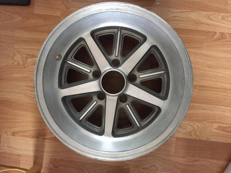

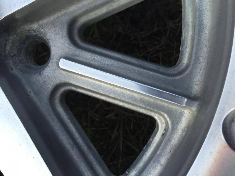

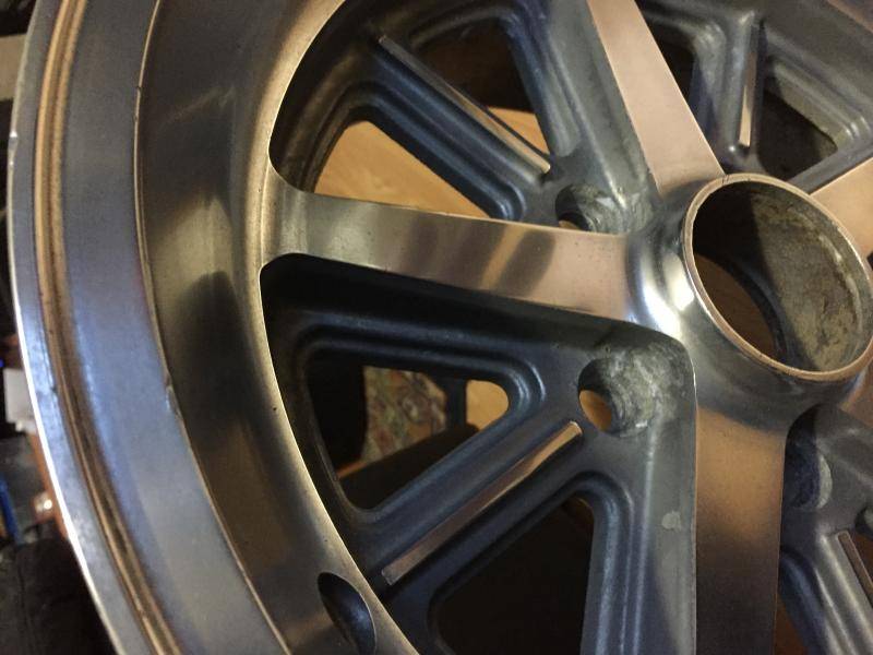

Update to the 5 on 5 wheel experiment:
I took a chance and sanded out the thin spokes with 400 grit. They came out great, without too much effort. One of the thin spokes had a curved scratch/shallow groove beneath the paint. Had to use some 320 and some effort to sand that out. Then sanded the wheel with 600 grit. Looks like this now:
Some notes:
1. The crushed glass blasting has removed the machining marks. I saw then them I first started hand sanding the thin spokes, but did not see them in the areas that I had crushed glass blasted.
2. There are some paint globs from the factory wheel painting process. The blasting process could not remove the globs. I had to scrape the globs off with a knife. on this one wheel, I only had one, but I think that there could be some, or none, on the other wheels I have
3. underneath the paint, there are areas that have surface defects, in the form of pinholes. The pinholes were filled in by the wheel paint, and only became visible when I started sanding with the 600 grit sandpaper.
4. The shapes in the wheels are a lot more ocmplex than they appear. I orginally started with a sanding block, but quickly found that the rigidity of the sanding block did not allow me to get to the entire surface. I went back to handheld paper, and got better results.
5. Getting the aluminum dust takes effort, usually needing multiple wash cycles with water containing dish soap. I like to clean the wheels after every pass, in order to be able to clearly judge progress, and 2-3 wash cycles between grits.
Going forward, I will be continuing the sanding process, eventually getting to the 3000 or 4000 grit point before I stop the sanding process. I would love to try to use polishing compounds, but don't know how (I have never done even this before), and I am a lot more comfortable with just sanding. After the sanding is done, I will be painting the dark grey (undanded) areas with either matte, or semi-matte black.

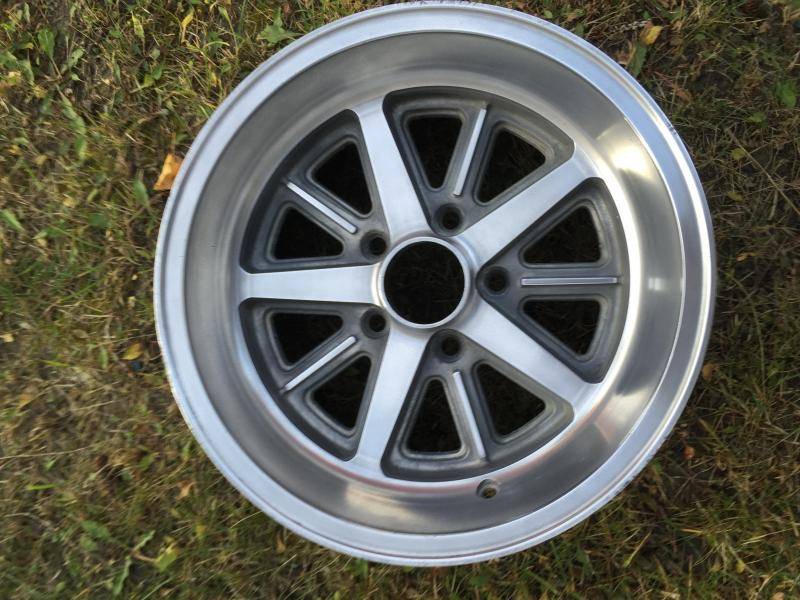

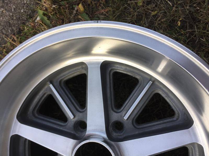

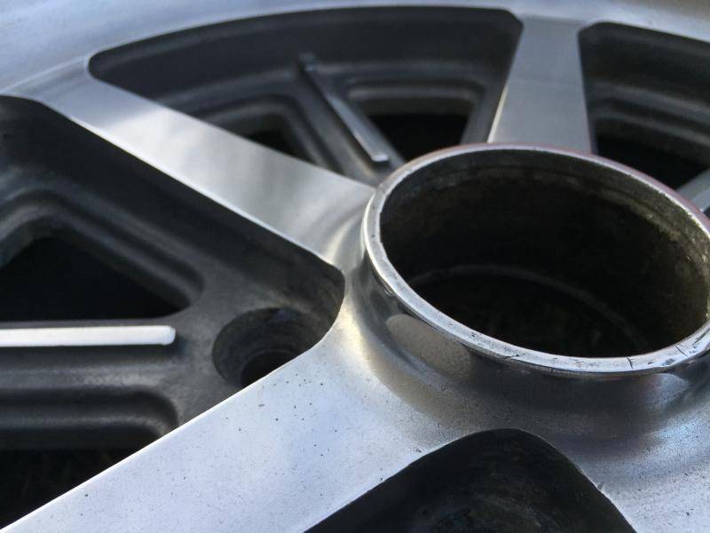

Snine is not where I want it, but I did see a major improvement going to 600 grit from 400. I still have a couple of defects that I want to clean up before I move on to 1000 grit.
I just had a thought that if somebody was interested in a more "sating" or "low gloss" finish on the wheels, they could stay at 400 or 600 grit. To each their own.
Forogt to knote that the sandpaper tens to wear out pretty quick. I will be trying out Micro-Mesh from 1000 grit and up.
Also, sorry for the delay, I spent a month in Montreal visiting with my mom, so couldn't work on this much.

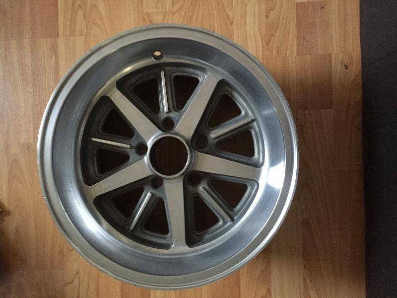

Thought I would complete the documentation of the experiment,as I have now figured this out (I believe).
From the previous pictures, I took it to 1000 grit wet/dry sandpaper. I then received my sanding pads from Micro-Surface, and continued going progressively finer. I went from Micro-Mesh 3600 to 12000 (don't get excited, 3600 is the equivalent of 1350 grit, and 12000 is somewhere around 3000 grit). I didn't take any pictures, because the differences would not have been visible in digital pictures.
I will go through the last part of my process, completed this afternoon after work:
Wheel looked like this, sanded out to Micromesh 12000, sprayed with Flitz Aluminum Pre Clean:
After polishing out with Flitz Metal Polish and their Large Buff Ball (Power Ball equivalent, but made of strips of Microfiber felt vs. foam):
That is a little bit harder to see because the background is different, so using the same background as the previous pictures:
Some close ups:
(edited to add the final picture to show the level of clarity/gloss; reflection of my hand)
To document this from end to end:
1. Abrasive blast with 60/30 crushed glass. This also removed the machining marks.
2. Sand with Wet/Dry sandpaper starting at 400 grit to 1000 grit.
3. Using Micromesh, continue to sand from #3600 to #12000.*
4. Spray on Flitz Aluminum Pre-Clean and wash off with water. Dry off any water.
5. Using the Flitz Metal Polish, go over all surfaces that are bare metal. Final wipe off of any polish residues.
*I am not sure the Micro-Mesh pads are the best way to go. It may be better to go with the Micro-Mesh sheets. Probably better value for the money.
I am also not sure if the Micro-Mesh step is even necessary. I may try going straight from the 1000 grit sandpaper to the Flitz polish.
I don't know if the Flitz polish stuff is the best stuff out there or not. I'm not saying that it is, its just the stuff that I had. I'm sure that a lot of other products on the market would do a good job, possibly even better than the the Flitz stuff. I'm just happy with the results that I got.
