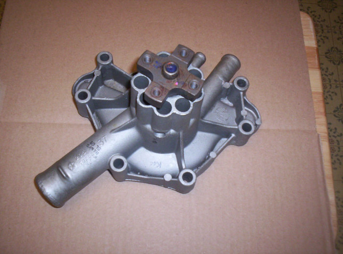

This the light duty of small block water pumps from 1970 to about 1987ish (with several holes on front part of snout).

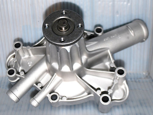

This is the heavy duty small block water pump, first used for police cars and other HD usage at about 1976 and finally for all small blocks at 1987ish. The two water pump bearings are much larger in diameter and give far less problems than the earlier design. Matter of fact – I will not install the older (small bearing aka “hole” type) water pump – because they just do not hold up as well.
Note: the lack of complete holes on snout.
If you are restoring a numbers perfect car – then maybe . . . (but not me – I will go with the HD version (“no holes” design) every time).

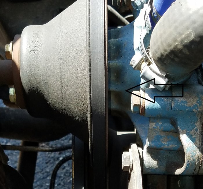

This is a cropped picture from post # 17. A black arrow shows you what I was looking at. Sense this is not a police car and sense the orange RTV wasn’t painted tells me this pump was replaced before. Also, the factory didn’t use RTV on small blocks – and the RTV Chrysler does use is dark gray – almost black) which tells me this was done by a non-Chrysler repair shop (or by previous owner).
Does this help?
