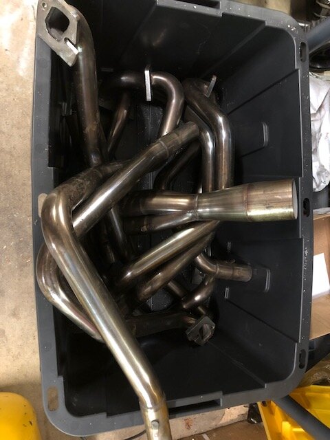

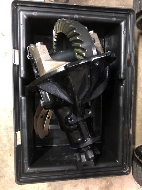

Very pleased with the 2020 season of racing with the Aspen. The highlight was my win racing with the Buckeye Stock/Superstock Association at KilKare raceway on August 22nd. By the way this is a great group of racers to be associated with. Also raced at the Jegs Sportnationals and 2 NMCA races, St. Louis and Indy. Best ET and speed for the car was 12.59 @ 104 mph. Plans for improvement over the winter are stainless steel custom headers purchased by a fellow Aspen racer and a new 489 case center section from Moser. Hope to pick up around .25 to 3 tenths with these additions to the car.
