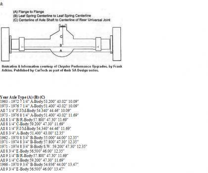

lastW6:
If you want to use the entire rear end (I have no idea if it fits) see the dimensions here:
http://www.forfmjbodiesonly.com/classicmopar/showthread.php?494-Rear-Hub-to-Hub-dimensions
see the post by Holmes.
If you want to use the internal parts only, the 2.24:1 and 2.4:1 carriers are supposed to be different from the other gears available (2.73-3.55:1), so this gets more involved. Most of the sure-grip/sure-track limited slip units are made for the 2.73:1 and up carriers/gear sets. This is from reading around postings on various Mopar boards.
In all honesty, it would probably be the most economical to get that 66-70 B body 8 3/4" (preferrably with a Sure-Grip already in place) and be done with it. Just an opinion.

Where's home ? Anywhere near Illinois ?
go 62-70 B body 8 3/4. 489 case is the less desired by other mopar folk, but good enough for our deal and more selection for sure grip. My luck got me a 8 3/4 with a 742 case. Diff parts are plenty and cheap. You won't kill the 8 3/4 ever. Ford 9 inchers are $$$$, but share the "drop out" center style design. If you are hell bent on the Dak rear- keep in mind the full size van used 8 1/4 in the 6 cylinder short wheel base. It is the larger lug patter 5 1/2, but you get bigger drums and can get the holes re drilled to 4 1/2. I tow with my van with an 8 1/4.... no issues. I just towed a 35 foot enclosed trailer. Again you should be able to get something to get it to do what you need.

View attachment 4622Year Axle Type (A) (B) (C)
