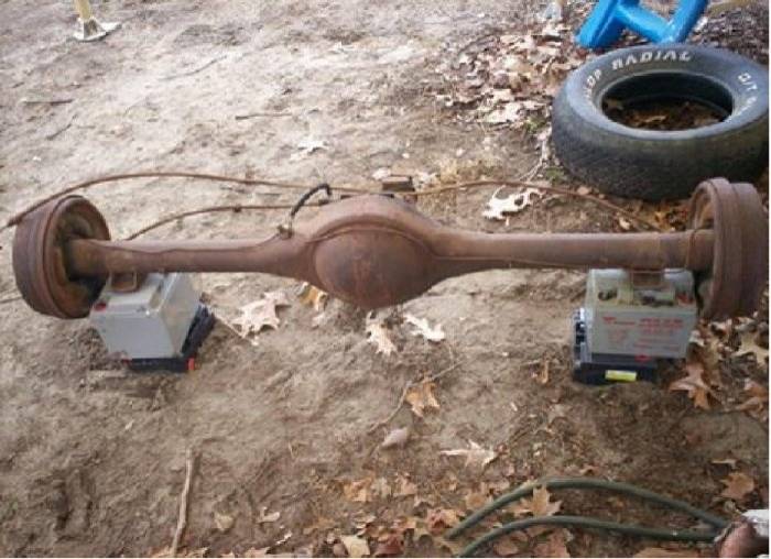

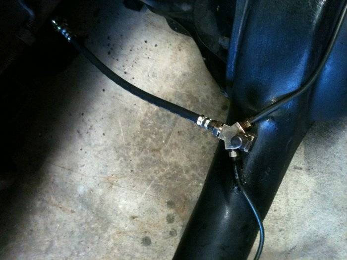

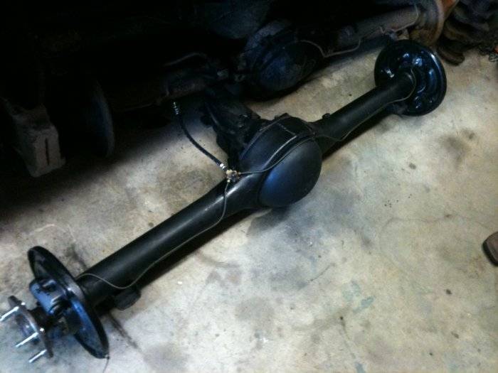

    And here it is after Gator's treatment @ Mopar Swamp - Clean and painted
    I better not break this one!

    Very purdy.what gears are you running?

    I also like the redneck jack stands in picture 1

    Which car is this one going under?

    I also own a pair of those jack stands

    It's got 4:11 gears and it "sure grip"s..... I'm posi-tive both wheels spin.
    This rear is going under my 79. As for the 77 4 speed car ( That I surely don't own- "I'm just working on it for some dude from the car forum").... the 77 will keep the 7 1/4...... for now. Recall 2 months ago I got a 70 b 8 3/4

    I highly doubt you'll be able to break an 8 3/4" :cool:

    You can break an 8¾” – but is really hard to do.
    Many years ago, I seen a guy carry a driveshaft, with the front half of a Dana 60 (9¾”) and rear half of an 18 spline A833, that he blew up in his Challenger.
    It did a number on the driveshaft, as well.
