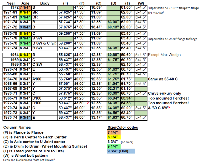

A bit late to the game here, but this is what (I think) he is looking for.
The top part of chart includes what should be a direct bolt in (not considering propeller shaft length), the middle section is other differentials that might fit (possibly), with little work.
The bottom section is ones that will need work like perch replacement and/or wheels made to get it to fit into the wheelwell without rubbing - sorted by flange width.
The PDF file (below) should be the same as the picture (above).
I also have an Excel file - but unable to download it, here.

I've got access to a derelict Ramcharger that I'll be stripping the 360/727 out of. I was considering just spending the dough to have the 9.25 rear cut down but the chart reminded me that the trucks use a 5x5.5" bp... back to confusing charts with numbers and stuff
1,492
What year Ramcharger?
Dodge increased the bolt pattern from 5x4.5” to 5x5.5” in early ‘80’s – so you can either find an older pickup (or car) 9¼” axle or get a custom axle(s) made. If your cutting one down, might be best bet to get aftermarket axles begin with.
The 9¼” axle has very little issues with it. Someone said it cheap and trouble free – but for FMJ’s, it takes a bit of $ to “make it fit”.
Something to consider, if your Ramcharger is a 2*4, the 727 should work fine for you. It if is a 4*4, you will need to find the correct tail housing and output shaft, so it will work correctly.
That said, Gear Venders makes an overdrive that will bolt onto the rear of a 727 once you un-bolt the transfer case from it – which might be something to think about (other than making the Gear Venders OD to fit with the stock floor pan).
