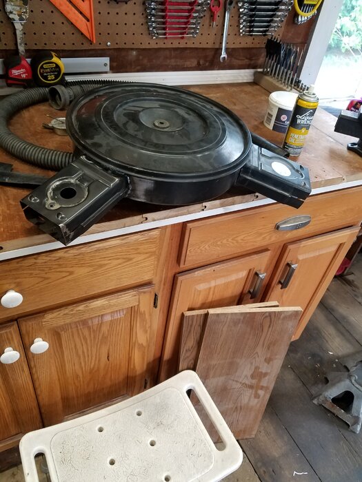

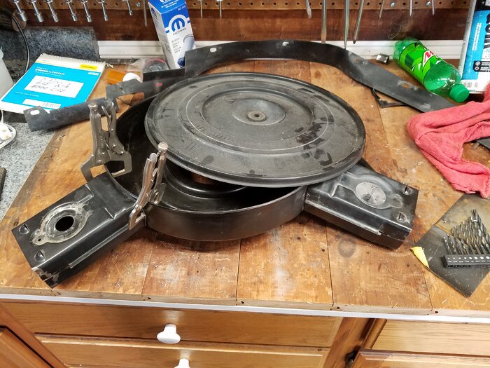

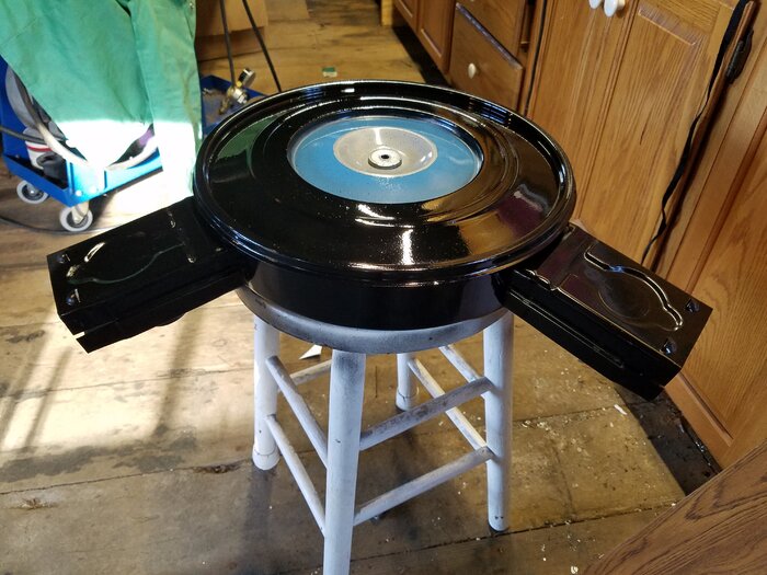

working on building a dual snorkel breather

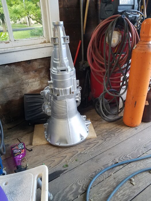

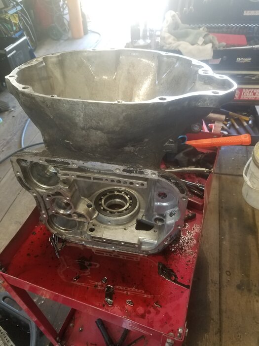

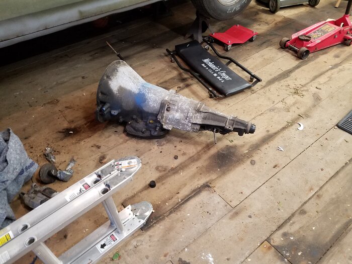

Alto clutches, to increase the number in each clutch pack. Either a 5.0 or 4.2 kickdown lever, new springs in the front clutch, possibly a beefed up rear planetary, and a shift kit.
