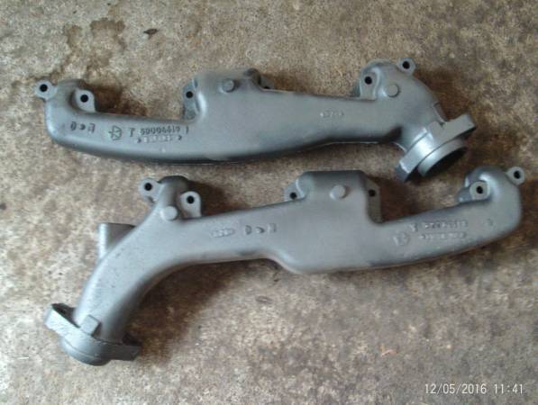

I wonder what the difference in flow really is. Is it really worth going after a 340 one for just the one side? And if you're getting into the power where it really makes a difference are you better off going to headers of some sort?
Those yesrs of Magnum manifolds look pretty even except for the longer tail on passenger one. Pic stolen from this post
[/URL][/URL][/URL][/URL][/URL]
It’s got to be marginal. I was doing a little more reading and the drivers side magnum exhaust manifold definitely seems to be an issue on most Mopar cars. I got caught up on just, what is the “best” not the best for our cars, lol
