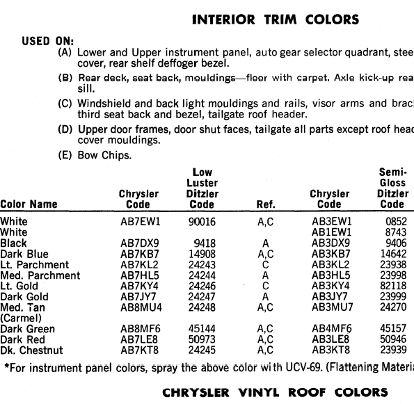

These are two pages from my '77 FSM (as a reference):

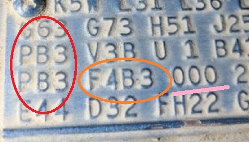

no paint codes that i have found are on the body plate, but i found a spray paint in walmart that is very very close ,so will use till i get this figuered out thanks for the help gjg
The seat color/type code will be on the fender plate (the four digit code - orange circle), the exterior paint (upper and lower, if different - red circle) and interior paint cold (pink line, and in this case NONE or doesn't apply).
There is noting on this, or the VIN sticker on door, that mentions anything about the steering column(or upper dash) paint color.
The only place you will find it is in the FSM, under paint.

This page is from my '77 FSM, so colors will not match.

pink line on my plate E44 HLCW for seat color VW3 for body color . I bought a can of rust-oleum classic navy in satin this is very very close, for me its a done deal. i am gonna try the dealer and an albert kemperal body paint store hopefully this wk n will let you know gjg
