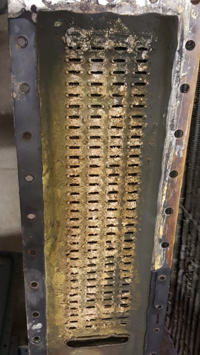

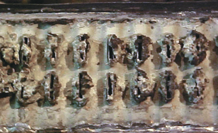

    The best way to tell if a radiator is getting (or is) clogged is to remove cap, look down towards the tubes and look. Most Mopar radiators (99%) with cap on top and center of the radiator, you can see at least a few tube tops.
    Corrosion will build up at the very edges of tubes. Corrosion will also be about the same side to side as well as top and bottom. If you look and you don’t see any corrosion or very little – then that is not your problem.
    If you do see a lot of corrosion – then you have a problem.
    Top picture shows one that has a lot of corrosion.
    This one has a mild case of corrosion – keep coolant changed every couple of years and yours will not become a problem like either of the above examples.
    A person might debate if this one will need to be cleaned, or not - but if radiator is already removed from car, you might as well get it cleaned.
    Corrosion is about the same if using a brass or an aluminum radiator.
    If you have a radiator that is not leaking – but looks like the top or bottom picture – a radiator shop can perform a procedure called rodding. They will remove both tanks and will use a rod the approximate shape of the core tube and insert it into each tube – manually removing any corrosion or other debris.
    This can be less expensive than a replacement – sometimes ( . . . but sometimes not).

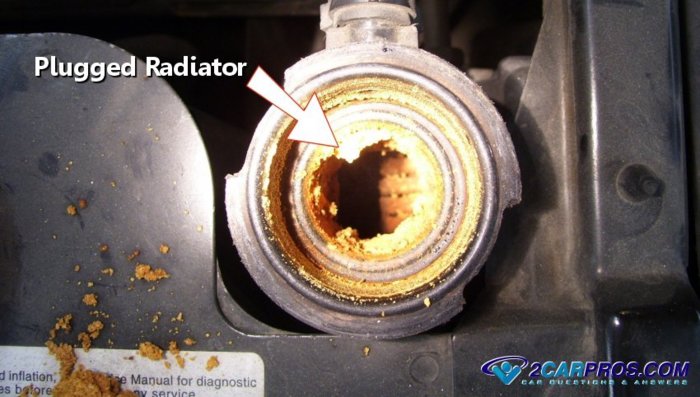

    Here is another picture. You don’t even need to see the condition of the tubes – to know that corrosion is an issue.
