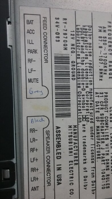

    What did that originally come out of? It looks right at home. The one in my 88 came from a Jeep I think, still works fine

    Pulled it out of a late 90s Jeep Cherokee. Was a direct fit/replacement. I Couldn’t be happier to have music again.
