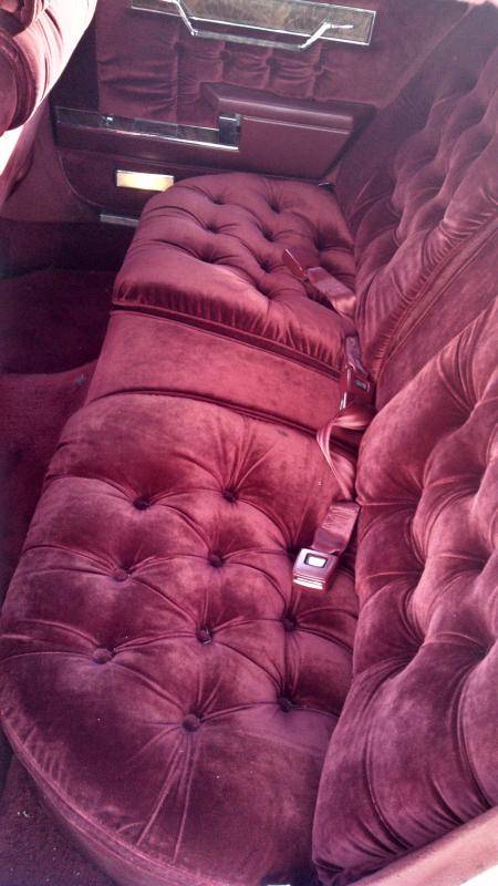

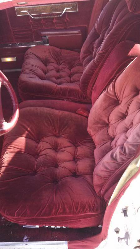

Interior's good, all the electricals work, was VERY well maintained for a long time, then pretty well neglected for a few years.

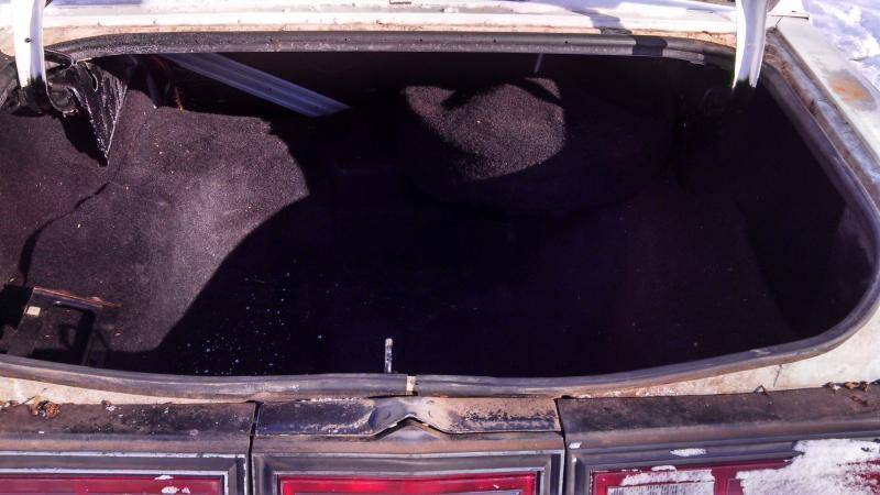

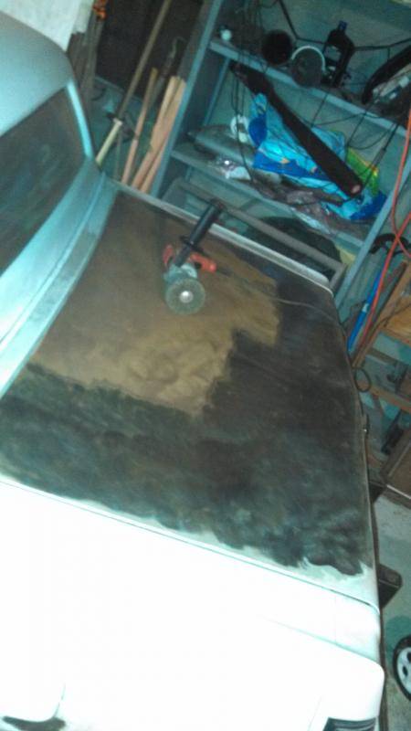

Rough or not....
I like 'em all.
Painting the trunk?
planning on it, right now I've been sorting the lean burn, gotten it better, but kind of given up on going further with it. picked up a used Edelbrock and thermoquad off cl for 100 bucks, have been looking into the conversion.
