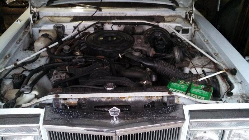

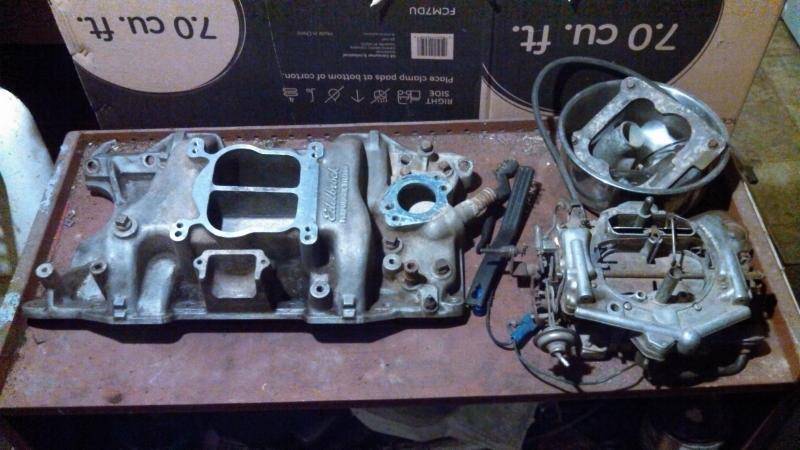

This is what I scored of cl for 100 bucks, I see Ed's not real popular around here, but if it'll work, who cares. Not sure if I should rebuild the carb and hope for the best, or use it as a core and get a remanned one with a warranty.

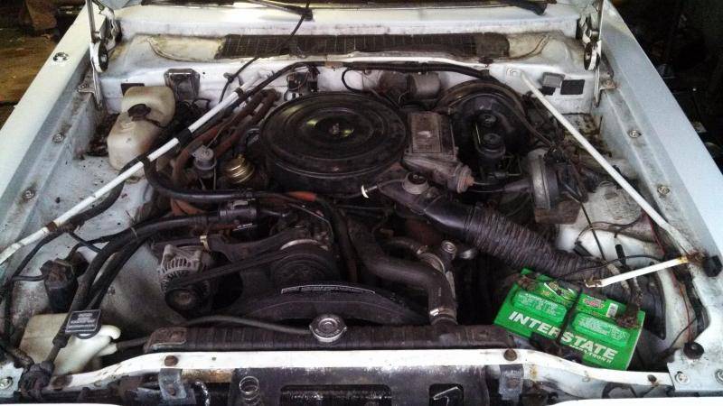

and this is where it'll go lol
a little grimy, but still pretty tidy
there is a possibilty of finding the correct linkages for a TQ, at least at a junkyard.
I have 3 of them within walking distance from my house, (used to be 5), they aren't always very helpful though.. they'll have acres of cars piled on top of each other, but somehow the person I ask about a part knows off the top of their head for fact that they don't have it. :bs:
Ditch the Lean Burn setup. The quickest & easiest way is to get any vacuum-advance distributor (points or electronic) and order up a Pertronix Ignitor I. It's so easy you won't believe it. However, if you want to do the Mopar-style electronic ignition used from '71-'81, I have an article somewhere that covers that swap including making sure everything's wired correctly as well as installing a four-barrel and intake. I'll have to dig a little for it, but it's in the pile somewhere.
Hmmm... this is an article I could probably make good use of if/when you find it also!
You don't want to go with a '71 ThermoQuad. That's the non-"solid-fuel" version, which is quite different internally due to the strange way in which fuel is metered in that year only, which involves bleeding air into the metering circuits prior to introduction into the venturi. They're not exactly what you'd call easily tuned or particularly good-running carbs; "tweaky" or "finicky" would be better descriptions. No big deal, though, since being 340 only, they're virtually impossible to find. In '72, the TQ got better metering circuits and also showed up on the 400 high-perf and all low-performance/C-barge 440s, but it's still not easily found.
However, in my experience, most TQs are useful as-delivered. Yes, you want the vacuum advance port but 4V trucks have that port almost universally during the TQ era. If you do have one without it, though, there are ways around it. One is to install the timed port yourself and the other is to use a throttle-actuated vacuum switch. The work to install the timed VA is almost done for you other than drilling a couple of holes (you will need a pin-vise drill and a tiny bit, both cheap) The electric vacuum switch can use the original idle switch found on ESA/ELB* carbs. Mopar used to make an electric vacuum solenoid, part number 4145181, but there are commonly-avaliable 12V solenoids that can replace it, such as Ingersoll Rand #P251SS-012-D. Neither option is particularly difficult.
Looking at Monkeyed's carb, the only wire I can definitively see is the one for the bowl-vent solenoid which also feeds the electric choke heater used on the carb's original application. That wire simply goes to 12V+ switch (key-on), so wiring it is a snap. All it does is close the carburetor's bowl vent when the key is switched off. Nothing magic about it, other than keeping the gas smell out of the garage. If you get me the list number, Monkeyed, I can tell you exactly what you've got there. The number will be stamped on the carb's mounting flange on the driver's side, facing the firewall. I can also tell you the CFM rating of your carb at that point, though they only came in 3 sizes: "large", "huge", and "now you're just being silly", also known as 800, 850, and 1,000CFM flow ratings. The 1,000CFM unit was never used by the factory and is readily recognized by the raised pads above the float bowls that say "Competition Series". No, none of these carbs is "too big" for your engine; that's the magic of the ThermoQuad. Tune it to spec and it's a perfect fit every time.
Rebuilding the TQ is pretty straightforward using just the instructions with your rebuild kit (do not order a carb kit any other way than using the list number, ever!). One big area of concern being the two square-section O-rings low in the carb. They seem almost useless, but if you forget to install them, the carb will literally dump fuel into the engine. It will run, but it'll run quite poorly. I'm sure I'm not the only one here who's made that mistake. Trust me, you'll only make it once. Pop the extra few bucks and get a new pair of floats while you've got it apart. It's cheap insurance. Brass & nitrophyl will interchange willy-nilly, and though in my experience people seem to prefer brass, today's nitrophyl floats are virtually impervious to fuel soak and will last nigh-on forever.
Even ESA/ELB carbs are jetted fairly rich from the factory so tuning is pretty simple. The only real "trick" to a ThermoQuad is the secondary air valve adjustment, which can be done with 3 screwdrivers if you use a little intelligence, but the factory-type tool is easily made or readily gotten via sources such as eBay. Setting up the carburetor per the factory's '72 guide will result in excellent performance in all aspects: fuel economy, drivability, and those full-throttle dances that remind you why you wanted a four barrel in the first place. Click here for the table of contents; I highly recommend you print out each and every page (they're clickable in the table of contents) and set your carburetor up exactly as shown, including bending the linkages, etc. Yes, it all really does make a difference. Another tuning guide, perhaps a little less comprehensive but easier to print, can be found here. Whichever you choose to print for garage/driveway use, you'll want to have it laminated because once you fall in love with the TQ, you're hooked and you'll want to have this information forever.
