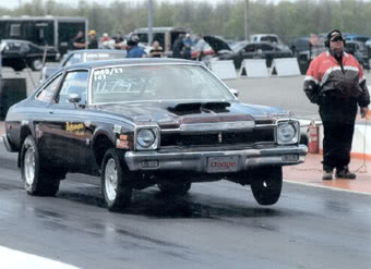

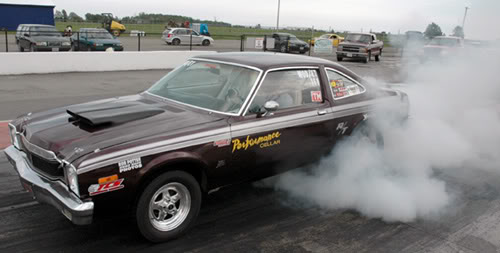

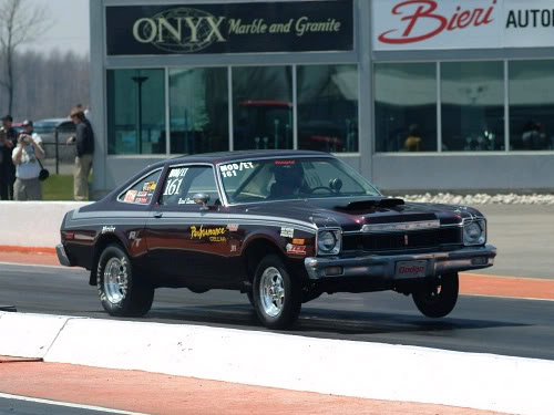

1977 Dodge Aspen R/T By Brad Sanders
This is really a update of my Dodge Aspen R/T as it has taken a few changes. It's a 1977 Aspen R/T with the original 360 that has had a few mods made to it. Bored .030 with KB107 pistons, balanced, crank turned 20/20, 596 heads ported and polished and fitted with 2.02 intakes, crane iron dutile rockers, Straightline-perf. cam, 240/252@.050 530/540 lift, air-gap intake, 800 Holley DP, TTI step-up headers.
Still using the 904 trans that has been great and now has a TCS 8" 4000 stall which will flash to 5000.The diff has been upgraded to a 8 3/4 with 4.10 gears and a spool is going in this week. Weld wheels help reduce some of the weight and give great looks and 28x9x15 Hoosier provide the traction for 1.55 60's 11.74@113.81 at 3420 with driver.
