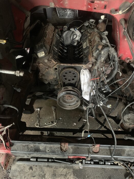

There are three ways to remove the engine from a B-van:
From above (engine only). You will need to remove one or both seats first and access to a cherry picker.
From the front (engine or engine/transmission). This might be the most labor intensive method and requires a cherry picker with a very short chain.
From below (engine and transmission): The way the factory installed the engine/transmission/K frame/suspension was from below, as an assembly. This will be the least time intensive method (ie: easiest). The down side is working with coil springs – which is not for the faint of heart for first timers. After engine is removed, the K-frame can be reinstalled to make the van, a roller.
Note: I don't think that has a Dana 60, but is a 9¼” differential. It would have to be a heavy ¾ ton or a 1 ton van to have a D60 – neither is seen without windows and several rows of seats.

Coming out through the front. It’s pretty easy to get the front clip pulled off these vans and I fortunately have a cherry picker with a single link of chain and a hook on the end. It’s been a productive afternoon.
