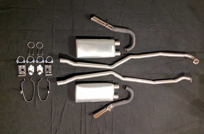

I would imagine the T/A exhaust would fit. Basically all you need are the mufflers, t-pipes with tips and the hangers. The pipes to the mufflers would be a custom deal. The parts are kind of pricey but are available.

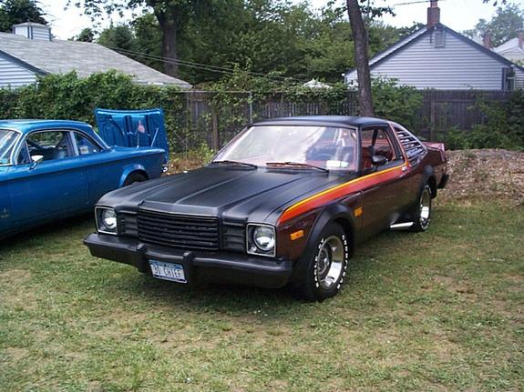

This one appears to have the AAR-T/A exhaust.

I'm looking at custom building it from the dynomax super turbo mufflers and mandrel bent pipe. Was just wondering if it's been done since I'm sure the under side of these cars us a bit different

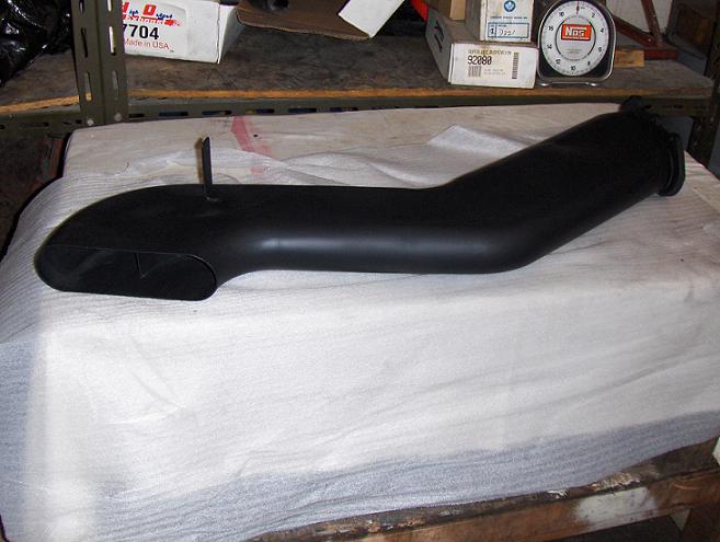

That last pic is custom made and iirc equal to 4".
The easiest way to do it is to get yourself some small diameter mandrel bent pieces and cut and weld them into the shape you want (so if I make it for my car I'd make 1.5" pipe to fit around the spring mount and over close to muffler exit) then once the shape is done with the small tube and all welded your put it on a band saw and cut it down the center. Figure out how wide you need for the given height (for 2.5" equivalent would be 1.5"x3.7") and your trace and cut out sheet metal to fit between the halves and weld it all together giving you a 1 off pipe to fit your needs.
