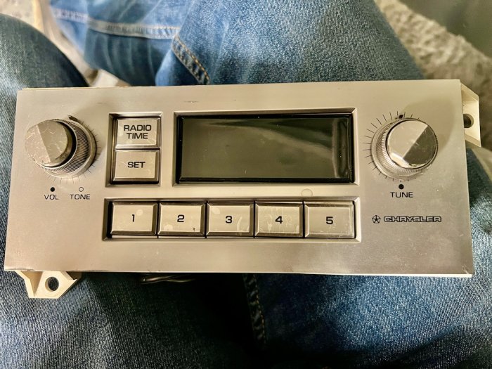

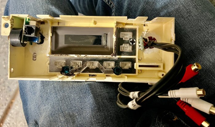

I decided I wanted to put an actual stereo system in this car since I haven’t had a real system in a car for many years but had all of my old components from my last one.
I’m trying to put as little into the car as possible and had an idea to use my phone as a head unit in the car and keep everything looking stock. A seriously modest and simple stereo but I wanted to use the factory stereo for volume and sub level control.
I got a Bluetooth Legacy 3 way crossover to connect to my phone and used a In line volume “pot” and gutted the factory AM radio. I modified the factory knobs and mounted them to both so the volume knob is actually volume and the tuner knob is the subwoofer level control and I added a 3.5 jack as another source option because… Well, why not!
bluetooth mod for OEM radio?

It wasn’t so much a Mod as it was a Gutting of the factory radio and utilizing the volume and tuner knobs as volume and sub level controls.
It worked but I wanted actual CarPlay so I ditched it and just went with a cheap aftermarket single din “tablet style” unit instead.
It’s a Boss and like I said it was cheap, it works great and I used a Bluetooth wireless connector so it connects as soon as the car is started. The 8” screen is adjustable so it works well with the dash layout minus the steering wheel being in the way but it works! I needed to have Maps and be able to easily see it.
Convinces I wanted as it is my daily and it sounds great!

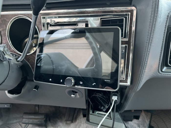

No, I wanted a larger screen to navigate through Phoenix using Apple CarPlay so I took a chance on a single din 8” “floating” adjustable screen.
It’s a cheap-o-Boss but rated well and actually works flawlessly!!It was new never installed on Offer up for $180 and they took $150!
You can’t program CarPlay volumes between navigation, messaging and phone but I’ve gotten used to the small annoyance.
Otherwise Super Happy! It doesn’t interfere with the HVAC system and no modifications required!
