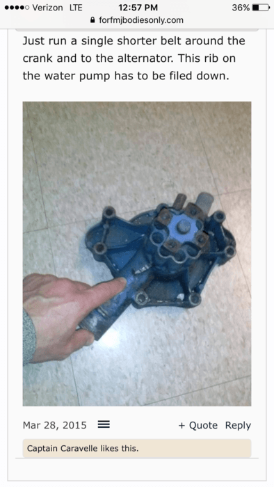

Use a “power steering belt” as it’s the right length.
1,828
1,031
This is the way. A lot of aftermarket pumps don't even have the rib that needs to be clearanced.

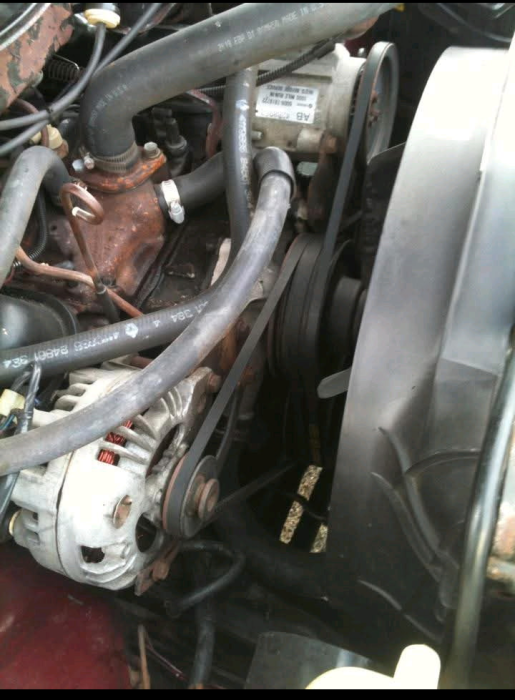

You can get the pulley you need off any 80's Dakota with the 3.9 V6 and no A/C.
I ran one on my old 87 Gran Fury, worked great. There's a right way and a wrong way to do everything. This would be the right way to delete AC if you needed or wanted to for whatever reason.

The no-A/C cars (that normally use the C-171 A/C compressor) use a bracket that has an idler pulley attached to it), that bolts in place of the A/C compressor. That way Ma Chrysler could use one set of pulleys and brackets for all small block cars (and V-6 pickup/van/Dakotas). The bolt in bracket works great if you are in a pinch (and if you have one).
The problem is finding a no-A/C vehicle to get one from - which means looking for a donor vehicle from up North (most likely) - for I have only seen a few of them around (in pictures).

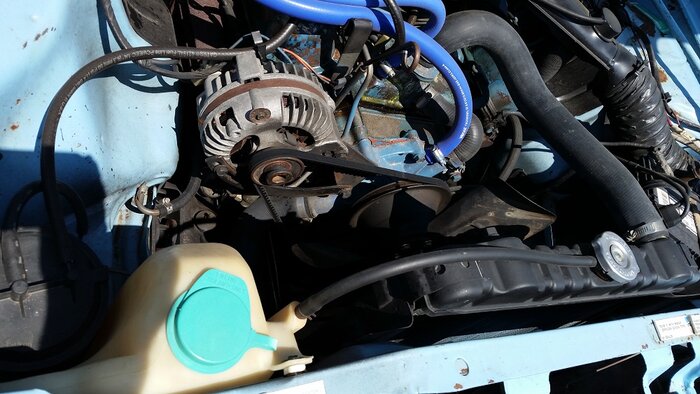

long term, if you do not plan on re-installing A/C and if you are racing the car, the best option is find an '70-78ish small block with-out A/C and get the pulleys/brackets from it. it will simplify EVERYTHING, look much neater and reduce a lot of weight.
Look at how much simpler this stock (no-A/C) setup looks (from my '77 wagon):
