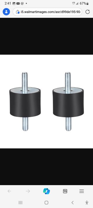

Would running aluminum frame isolators cause a vibration issue? Should there be a small rubber spacer from the support to the rad? Do you guys directly bolt yours to the core support?
2,992
I was thinking of rubber isolators for the mounting bolts. You'd need to enlarge the holes in the rad side brackets. Think larger version of say,,,,,,the isolators on the wiper motor.
Or, a type like in the photo. Problem with them might be the thickness.
I kind of did a quick look around, and it seems rubber mounting an aluminum rad is recommended by many to prevent cracking.
Important also for rubber isolated aluminum rad is to attach a ground wire, to help prevent electrolysis.
