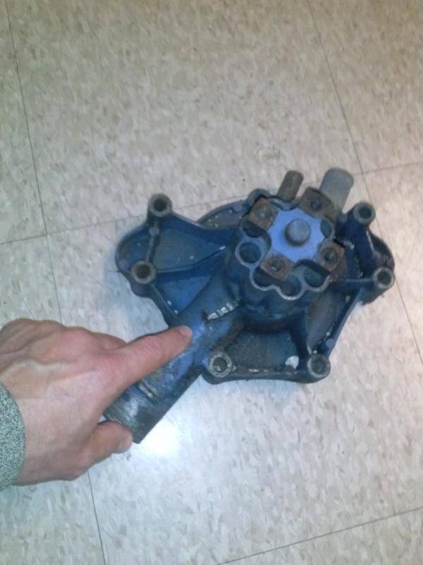

Just run a single shorter belt around the crank and to the alternator. This rib on the water pump has to be filed down.

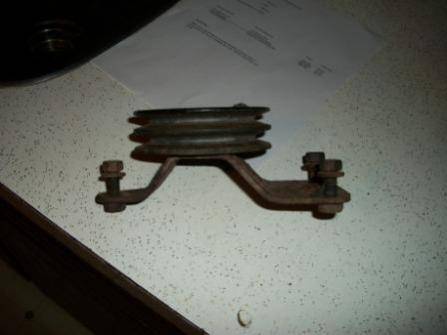

Option #2 is to run an idler pulley.
If memory serves.... they can be found in 1988-1991 v6 and v8 dodge ram's without a/c or 1987-1991 v6 dakotas without a/c.
