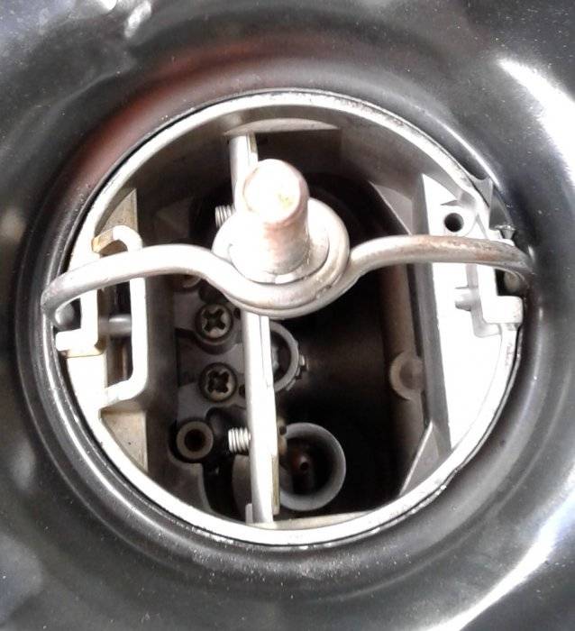

I was poking around this morning and decided to check the air filter and here is what I noticed: 1) The air filter is completely soaked with fuel and running down the sides of the housing. 2) The choke flap is in a vertical position and will not budge. 3) Very little suction on PCV valve. 4) Breather tube to air cleaner housing is smoking, smells like rich exhaust. HELP!

Well, It cold starts fine and seems to run good when warm. My car has 41k on it with a new carb(from sitting for years). What is causing the choke plate not to close?

I would advise not running your engine. You definitely don't want to risk a fire. Engine off and holding your throttle wide open, can you move your choke plate ? You may have binding linkage. Check your float level or needle not seating for the rich condition. Are you getting black smoke from the exhaust ?

If none of the above clears it up, I would buy another carb base gasket from a parts store, then remove the carb since you are relying on the previous persons installation skills...once removed, check your choke linkage to see if it operates properly and also check the black cover on your electric choke to see how far the marks are away from the centerline...could be completely pegged to one side or the other. Once the carb is removed, use an air nozzle on all of the openings and hope to get lucky on cleaning the ports out. My thinking is that debris or insects have clogged up a vacuum port and/or blocked your needle valve seats causing fuel to continuously pour into the carb, filling the bowls, and exiting thru the vents...except when the engine is running well and uses more fuel than is being pumped out the vents...when the car is running, keep in mind that your engine oil is most likely diluted with gas...does the carb look new or is it possibly remanufactured? Could be a bad rebuild...

It does not matter if the PO told you that they replaced the carb on the car. The key to your story is that you got the car after it had been sitting for an extended period. New carb, old carb, or one just out of the box; it does not matter, modern fuels are their enemy. The Ethanol in todays fuels will destroy the seats, seals, gaskets, floats, and o-rings on these carbs. The affect seems to accelerate if the car is allowed to sit for a long period of time.
Here are the facts: Your carb is dumping, or leaking large amounts of fuel into your air cleaner. This is bad. You say the car bogs down on acceleration. These are all things that point to the fact that this carb, no matter how new or rebuilt, needs to be rebuilt again.

I suspect either a carburetor needle/seat issue and/or a float that has absorbed fuel (therefore not floating any more). Either case will require carburetor removal and rebuild.
If the engine is warm to hot, the choke flap will always be in a vertical position. If cold, it will at an angle, at least until someone taps the throttle to reset it to a full choke position. If you mentioned engine temperature in your posts, sorry – must have missed it.

Note: as to the choke operation, I would like to see outside photos of your Holley 6280 from both sides, so I look at your linkage setup.

Can you post a photo of the whole carburetor, without the air cleaner on top?
Can you see fuel squirting into the carb when you operate the throttle by hand?
As for your choke, the adjustment screw may be out of whack.
Either way, post a lot more photos, or video of the car running if you can.
