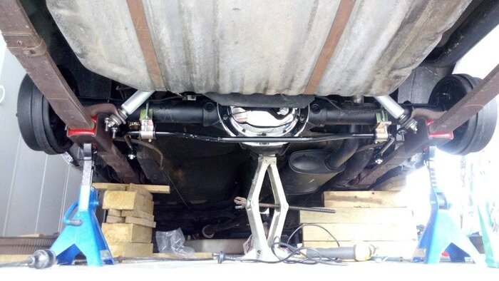

I am floating around, but as my car is pretty much done I am not up to much on it, I want to try an air shock in one side to help give the car better straight line take off traction. This is what my car looks like underneath.

You do have the ISO clamps still in place (and using red urethane biscuits). It looks like the only air shocks that will fit (without major modification) will be the the Monroe Max MA750. It looks like this part is about to be discontinued . . . maybe.
