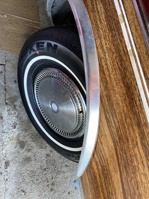

Thanks to Mopar Dan I have replaced my two dented wheel well trim pieces. I assume these are aluminum - i tried vinegar and steel wool, any suggestions on how to rebrighten the trip?
2,992
You can't really brighten it up. They are aluminum but are clear anodized over a "bright dip" type of coating. The only way to get it bright and shiny again is to strip the anodizing and bright dip off and then polish the bare aluminum. Problem with that is it then needs constant care and polishing or it starts to turn dull and whitish fairly quick. I stripped and buffed all the window trim on my Aspen, and I need to use a polish (I use Griot's Garage Metal Polish) every couple months, and it spends 95% of it's life indoors. I tried an aluminum protectant (like Zoop Seal) but it didn't really seem to help much.

Thanks, I think I may just roll with it! It’s not like it’s a rust free wagon so I can’t get too crazy… yet!

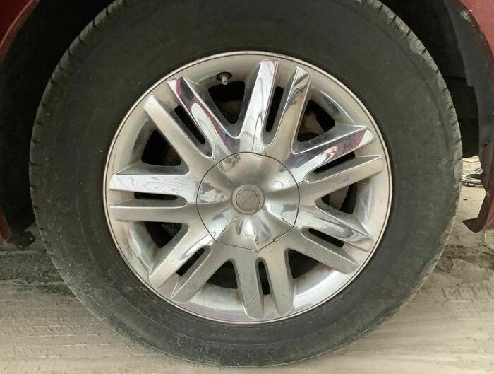

My wife's minivan has "chrome clad" aluminum wheels on it and I wondered how they got the chrome to stay on it.
These wheels sure look fancy when clean (when dirty - um, not so much). The one in this picture is dirty.
What Chrysler did to this wheel is a (more or less) rough cast aluminum wheel with a thick chromed plastic piece snapped onto it. Most (except for a tiny lip at tire) of what you see here is plastic.
