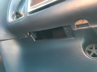

Hi. have a 1987 Chrysler Fifth Avenue and noticed and opening below the glove compartment. I have seen a couple of Fitfh Avenue and they all seems to have this opening, no block-off plate or light or anything. Somebody knows? Pics? Thanks...

It depended on the options that was ordered on the car. Some came with a map light/courtesy lamp some don`t. Also some cars had the harness to plug directly to the light and some you need to find a small harness for the light off another car or a NOS one.

Ok, thanks, but it is a bit weird it doen't have a plate or something to block the hole if you don't have the option. Besides, a Fifth Avenue comes with the light group, (truck light, glove box light, ash tray light, courtesy light, ect...), so why does this light is missing? I would think it should be part of the light group?

I think the option was discontinued somewhere down the line. I pulled one from a junkyard car and wired it into my 87.

That's for the courtesy light. My 78 Le Baron has it. None of my diplomats do. I suppose the UAW would have screamed bloody murder back in 1978 if you had forced them to put a small blank plate and two screws into that cavity.

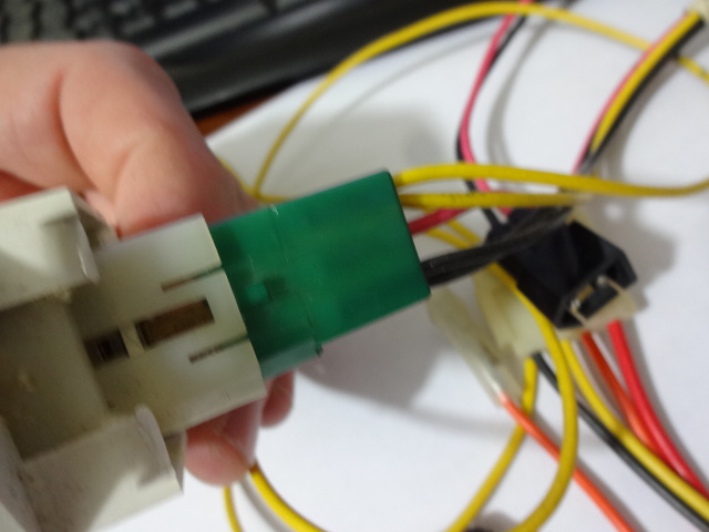

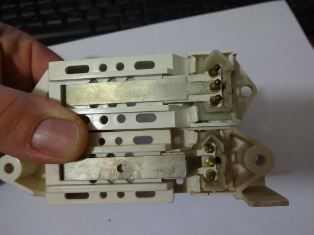

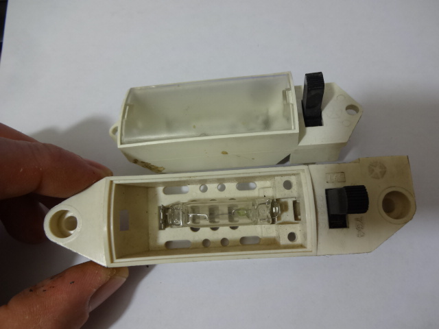

You need the longer one in these pics, both nos dusty but you get the idea. Shorter one is F

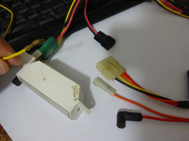

It should be part of your harness under the dash that also has the glove box light, the yellow to cowl ground and the cigg lighter and the cig lighter light, if I remember correctly.
Ive a used lil harness if yours dont have it.

But the main harness does have the 4 wire male plug for it, about 8-10 inches to the right of the fan speed plug. At least the ones ive got. Or is it like some of the engine wire harnesses that do or dont have the fender turn indicator plugs?
The added harness is 3843611 on the f and there is even another wire with a pn (3843XXX) that plugs into the orange lead and splits into to, maybe the dome light or, its a long lead.
