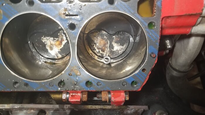

Was in a rush installing a new intake manifold two weeks ago and didn't jam paper towel into the ports like I typically do. Guess which valve was wide fucking open out of the eight on that side? This car hates me.

I can feel that strange sensation of your chest twisting up as that happened just by looking at that.
Yeah, there wasn't even any hope of it possibly still being in the head after I saw it go in. The noise it made I knew not only did it go into the bore, but the piston was all the way at the bottom. Fun times.

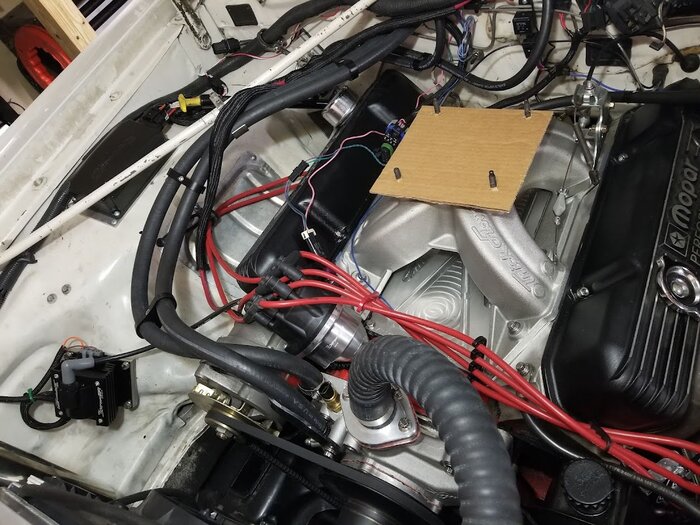

Head is back on with the rocker gear and cover. Exhaust is all bolted back together. Got the front of the motor torn down now for some changes. Going to a driver's side outlet water pump housing like the factory. Trying to figure out how to plumb the radiator now, or just to replace it. Almost there.

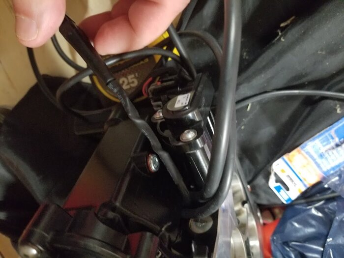

Amateur hour has turned into amateur season. I had the car running for my favorite car cruise of the year. Went to it and had a blast. Car was running great with full timing control and everything. Had a crowd on the side of the road hollering for me light the tires so I turned the idle up 250RPM on the handheld and opened the electric dumps for it. Damn I love this hobby. Had a small oil leak from the solid valley tray I installed though due to being stingy on the black RTV.
So I took it apart the following weekend, sealed up the leak and put it back together. In the process of doing so I didn't notice that the handheld wire for the Sniper EFI was under the throttle body. I bolted it down and started the car. Massive vacuum leak. Sounded like someone was playing a kazoo through a leaf blower. After I pulled it apart I noticed I had crimped the wire in two spots. Handheld was dead. I took it apart, cut the bad sections out and soldered it back together, taking care to shrink tube the four individual wires as well as using a piece over the entire bundle. Repair came out good, but the handheld was still dead. Something must have shorted, so now it's back to Holley for repair.
I have been my own worst enemy this season. Only put maybe a 100 miles on the car this year.

Putting heat shrink over heat shrink doesn't always work. It can make the first layer split open when the outer one is heated. Not sure how I know this. ;)
