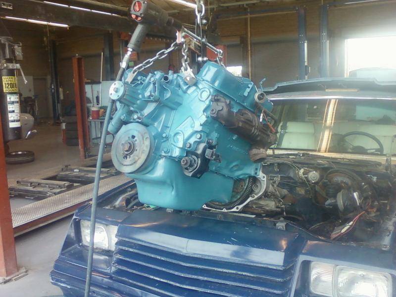

Engine back in its home, still have everything else to do,wiring plumbing etc But at-least it is not in the back of my truck bottoming it out over every bump I hit. And of course the hobby shop is again closed till the 2nd. Gives me time to catch up on my shows.
Wish it was as fresh on the inside. Hopefully It is cured of marking its territory, and I wont get so dirty working in it from now on

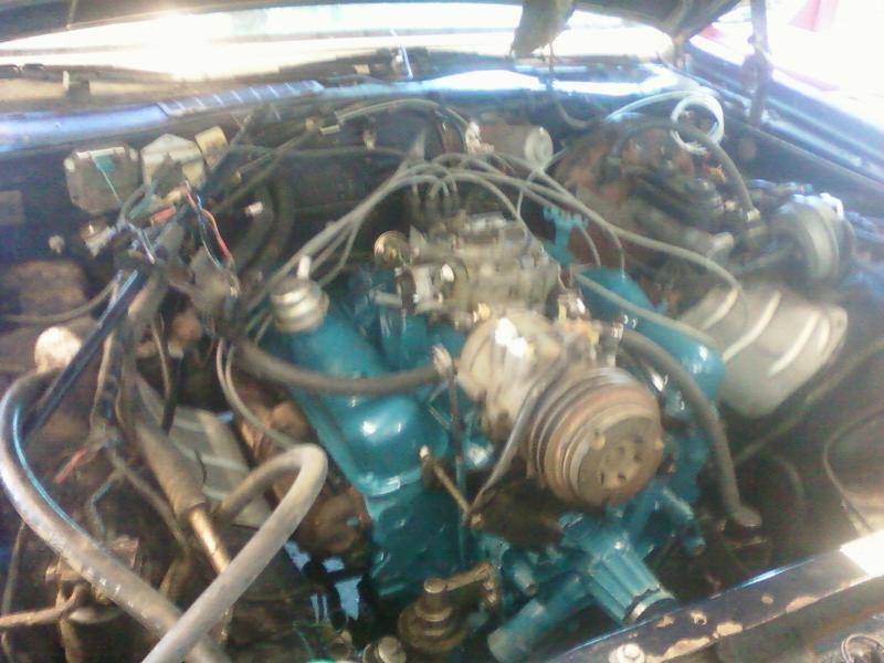

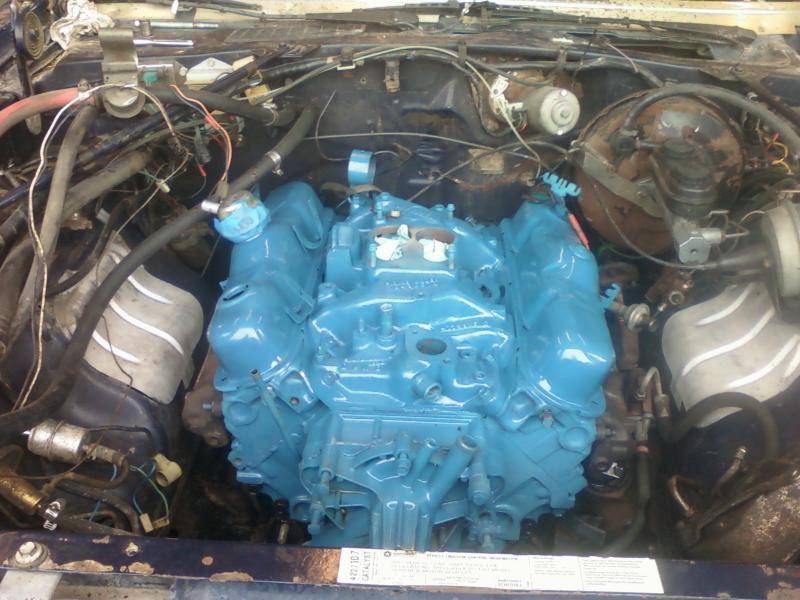

Well its been a while since my last update. After getting the engine installed and all hooked up again.
I couldn't get it to crank over, after a few hours of checking everything I finally went home and reviewed my service manual and realised the wire to the starter relay on the firewall was off.
Now its cranking !, But I don't have spark, looking over manual again and using a test light on the connectors that I thought were to the old "Lean Burn" were actually the two connectors that needed conecting to power the solid state ignition.
Now I have spark (Yea!) but It is still not firing, thinking I had fuel soaked the plugs with all the cranking I had been doing, I let it sit over night.
The next day I tried again, spark but still no fire.

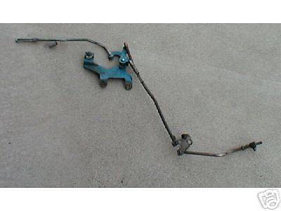

Finally got the 4bbl kick down linkage I needed and installed it
All the while I was wondering why I wasn't getting any oil pressure or any oil at all to my new mechanical oil PSI gauge.
Researching over night I learn all about Chrysler's legendary oil pump priming difficulties. Crap! now what?
Well, I tried cranking the crap out of it, No pressure,
Pulled the plugs out of it and attached a booster battery charger and spun the piss out of it, No dice!
Ordered the specific oil pump priming rod and waiting several days for it to be delivered and then tried to pull the intermediate shaft to access the oil pump, It wouldn't budge well that was a waste of time and money.
Even tried to pressure the crank case by shooting air into the engine thru the oil dipstick tube but the rings are so worn it didn't even come close to building pressure.
Tried to prime the oil pump through the oil pressure gauge sender hole, After 2 quarts of oil down the hole spinning the engine with the starter still no pressure! ARG!!!!!!&^%#%^&*^%$!!!!
While considering my oil pump woes I changrd the idler arm in the steering and the sway bar end links.

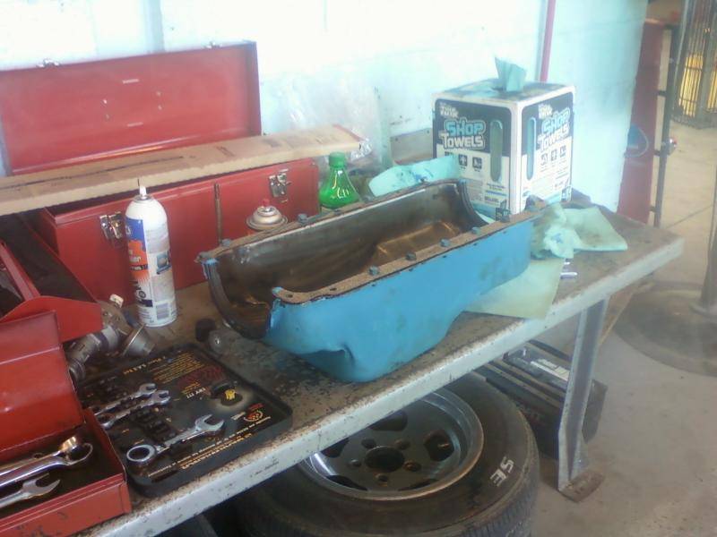

Time to drop the pan, DAMN!
while down there, replaced the oil pump with a new high volume one which by the way was identical to the existing pump but cleaner, packed the new unit with pertoleum jelly and got the pan back on just in time to clean up for the day.
Well the Hobby shop is closed sunday and monday and I have school all this week so I will probably have to wait till friday to see the fruits of my labor if there are any.
Oh Yea, I forgot mention the intermediate shaft for the oil pump, that would not come out, I had to use a hammer and punch to drive it up and out due to the varnish build up on the shaft. Maybe I can use that oil pump tool I paid for this time.

NoCar340
Dec 7, 2013
1,240
179
Upper MI
If you had to use a hammer & punch to remove the oil-pump shaft, you might have something wrong in there. That shaft shouldn't be that difficult to remove, regarldess of mileage.
The only difficulty, actually trick, to priming a Mopar V8 engine of which I'm aware is that it's a two-man operation. One guy runs the drill while the other slowly turns the engine over by hand using a large ratchet on the crank bolt. The Chrysler's cam oil ports are timed and have to be turning to get oil to the top end. You should've gotten oil moving while cranking with the starter, but it's not like you're going to see much, if any, reading at the gauge with the engine turning that slowly, particularly on a tired engine. Taking off a valve cover will let you know for sure; if there's oil on the rockers it's moving oil.
I had this problem with a big block once. It turned out the machinist had left an NPT cam galley plug out... the main one. The drill would spin and spin, but never drag down. The pump was primed, but the oil was just draining back into the pan behind the timing cover. It took me the better part of a very-cold day to find the problem. You didn't get that far into the engine, so I highly doubt you've got a similar issue.

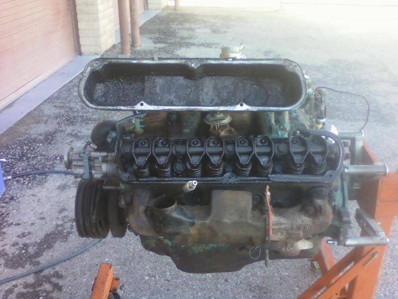

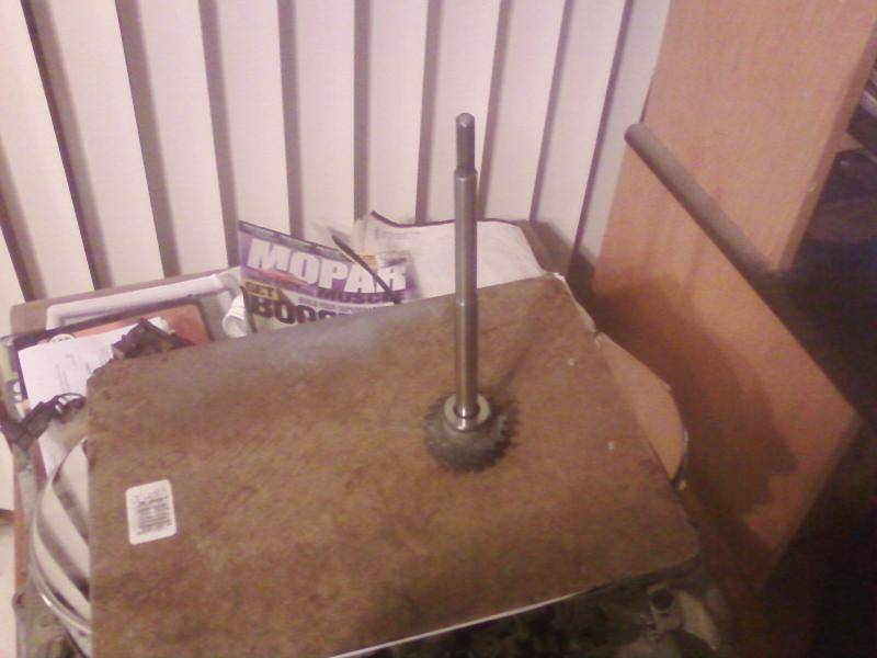

The engine has yet to fire since reinstallation. I believe that the absence of oil pressure has caused the hydraulic lifters to pump down preventing its firing off and since I have yet to get any oil to even leak out the oil sender hole so far Leads me to believe the pump isn't pumping.
The whole engine inside and out was crud covered with coked oil and varnish, Check out inside of valve cover
The engine ran reasonable well for as tired as it is, so I am hoping it was just crud holding it in place.
I polished it up by chucking it in a drill and spinning it while using scitchbrite to shine it up
Anyways I am hoping this engine will hold out for a few years till I can get my garage built, then I will redo the 94 5.2l magnum motor ans A-518 OD trans I have stashed away
and this whole current thing started just because I wanted to change out my trashed transmission.

NoCar340
Dec 7, 2013
1,240
179
Upper MI
The lifters not being pumped up will not keep the engine from firing. They will still lift the valves. The engine will run without an oil pump installed, in fact. Just not for very long.
