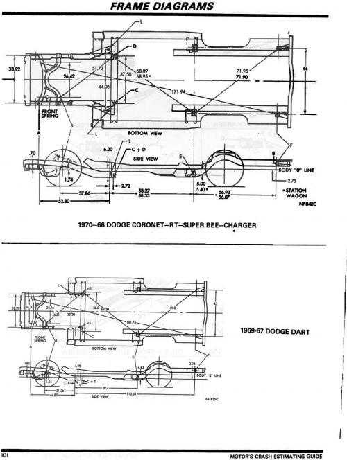

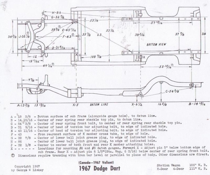

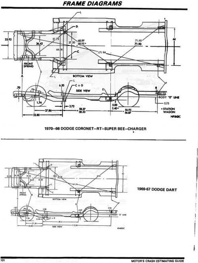

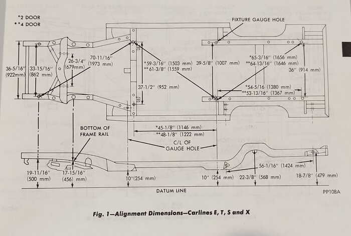

Ok next crazy thought. Does anyone have the frame diagrams for late A body and for an F body? Now I'm curious how far the dimensions are off between the two.

a Bit delayed, but I was bored and found the one for the earlier Dart.
truth be told, I had kicked the idea around myself for the front framerails just to get more suspension options.

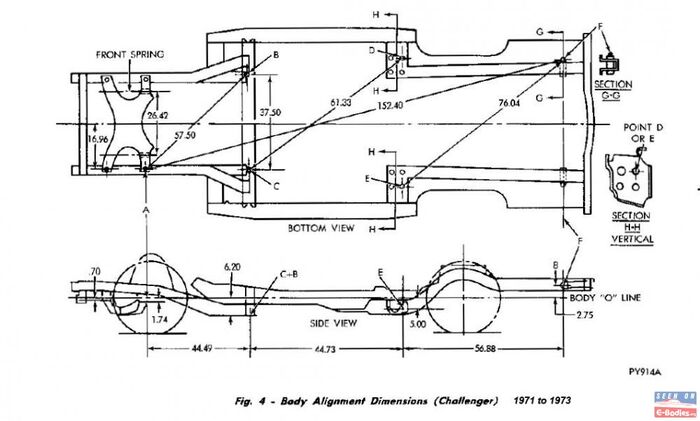

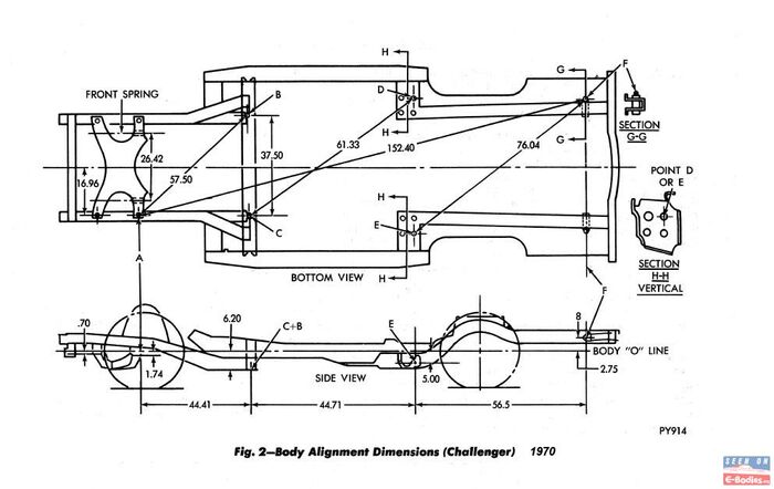

Found the Challenger's too:
